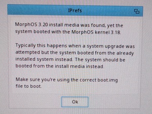

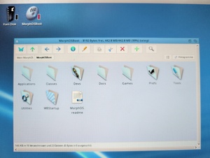

    It's the first time I try to install MorphOS 3.20 via USB (because I don't have any blank CDs left), but I couldn't find a way to do so.
    What I did:
    - Download the USB boot image from morphos-team.net (morphos-3.20-hybrid.hdimg)
    - Write the image on a 4GB-USB-Stick (sudo dd if=morphos-3.20-hybrid.hdimg of=/dev/rdisk4 bs=4m)
    - The USB-Stick is recognized by my MorphOS 3.18 installation, but unfortunately you can't do the install from there (see attached screenshots)
    - When entering the Boot-Menu of the Mac (pressing the "alt" key) there is no USB-Stick from where I could boot
    - Using Open Firmware I didn't succeed booting from the USB stick, the documentation (https://www.morphos-team.net/guide/usb-boot) is very strange, because it descibes how to create a new boot media and there isn't any reference to the .hdimg-file you downloaded before.

    I'm not even sure if you can USB boot a Mac from the .hdimg (never managed to boot any PPC-Mac from USB).
    The error message shows that you still loaded the boot.img from HDD which is 3.18 and won't do for install.

    Well the .hdimg is SFS so OSX or OF won't be able to read it.
    It should be possible to place the mac_ppc32 boot.img on the boot: partition of the HDD (that can be read by OF) them manually boot the file from OF. Once it is started it should see the USB stick as a bootable device (similar to what is seen in OP's error message) and just boot.

    hiTCH-HiKER
    Posts: 172 from 2003/12/31
    Thanks a lot for all your quick replies!
    I succeeded using the quick & dirty way:
    1. Writing the .hdimg file to a blank USB stick (via dd, see my first comment)
    2. replacing the boot.img on my MorphOS 3.18 system with the new 3.20 boot.img from the stick
    3. reboot the Mac Mini with the USB stick plugged in
    4. Then the welcome screen appears (without iPrefs error message, because the kernal version matches) and you can start the installer and choose a new install
    I know this isn't the recommended way to install MorphOS, but booting from the stick didn't work, whatever I tried and this method worked like a charm.
