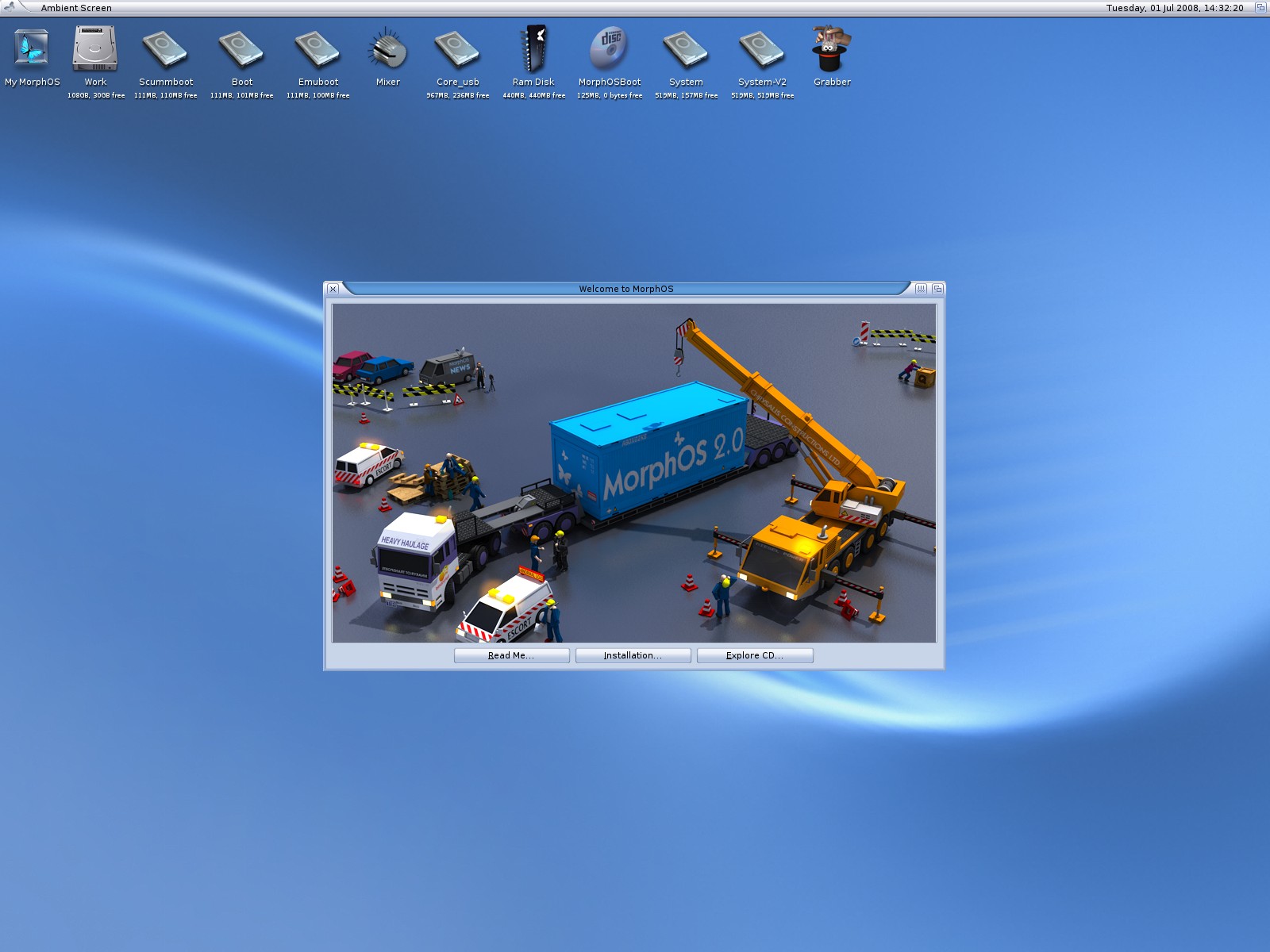

    There is a nice "Welcome Box" with an Image made by Christian "Tokai" Rosentreter.
    You have three options here, read the readme, Install MorphOS and Explore the MorphOS CD.
    Clicking on Install opens a nice Installation Tool called Iwizard. Wow, very nice, however I have no time to install it now, so I quit it for the moment.
    Exploring the CD opens the Boot CD, since I have no Time for the moment I just have a short look into the Applications drawer.

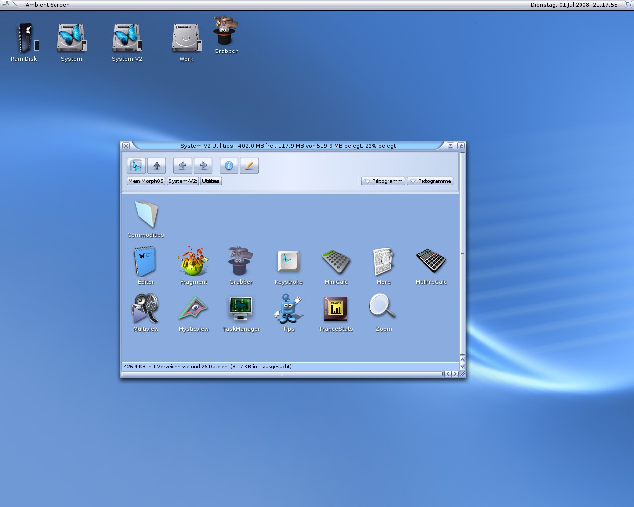

    I played again a bit with it...
    "colors, so many colors" ;)
    No really there is a lot new stuff there, even the good old commodities drawer is back ;) (with exchange and a reincarnation of no caps lock, just with a bit more options). BTW exchange, anyone noticed that we have now a bugreport facility? go check yourself ;)
    However, I was able to crash it allready *g* I played with the screenmode settings and all I got was a grey screen with titlebar. Have to investigate that later, I finally want to get that baby on my hardrive.
    Unfortunatelly I don`t have a free Partition for that.

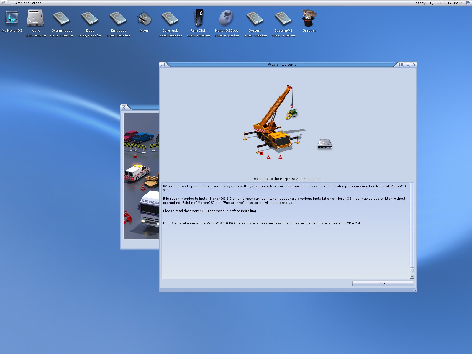

    From the "Bienvenue" Tool you can launch the "Iwizard" Installations tool.
    (If you have closed it by mistake you will find it in the Tools drawer of
    your MorphOS CD)
    This welcome Screen shows some usefull Informations, for example that it is not
    recommended to perform an upgrade over an existing MorphOS 1.4 Installation.
    I can second that, If I think about how modified my System allready was,
    it was wise to make a fresh install. Oh, and keep that mentiond hint in mind ;)

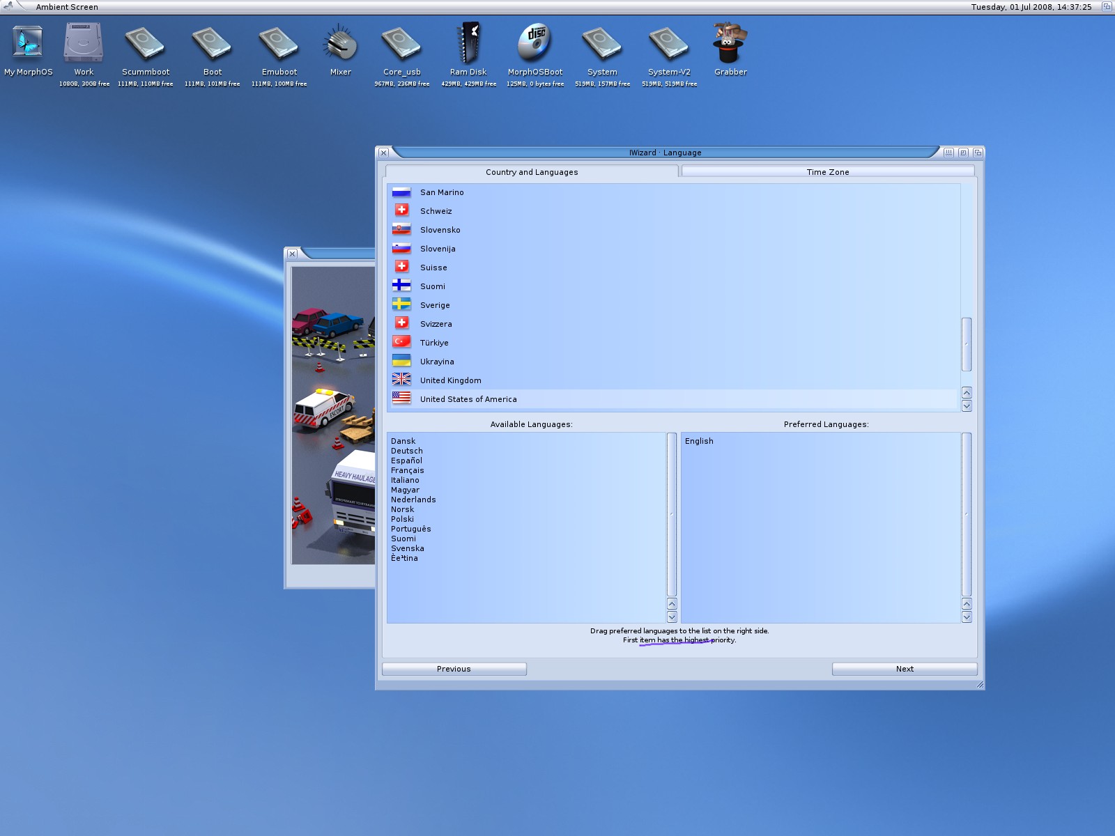

    Step two,language
    change your locale settings, should be easy.

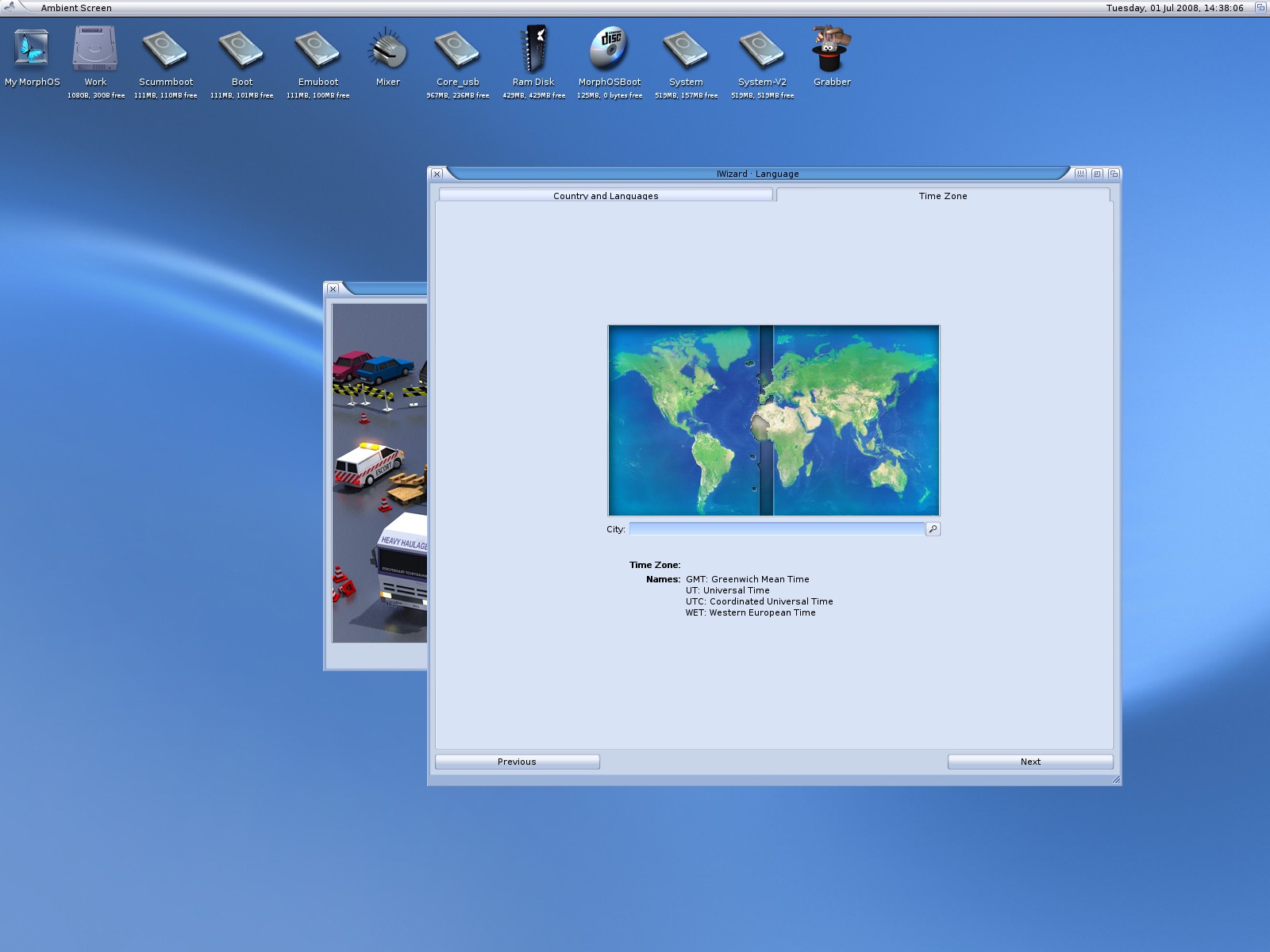

    Step two,timezone
    before you continue, you might want to change your timezone as well.
    If you hit the next Button, Iwizard will restart itself and from now on,you have you choosen language
    (Thus all the messages are in german from now on)

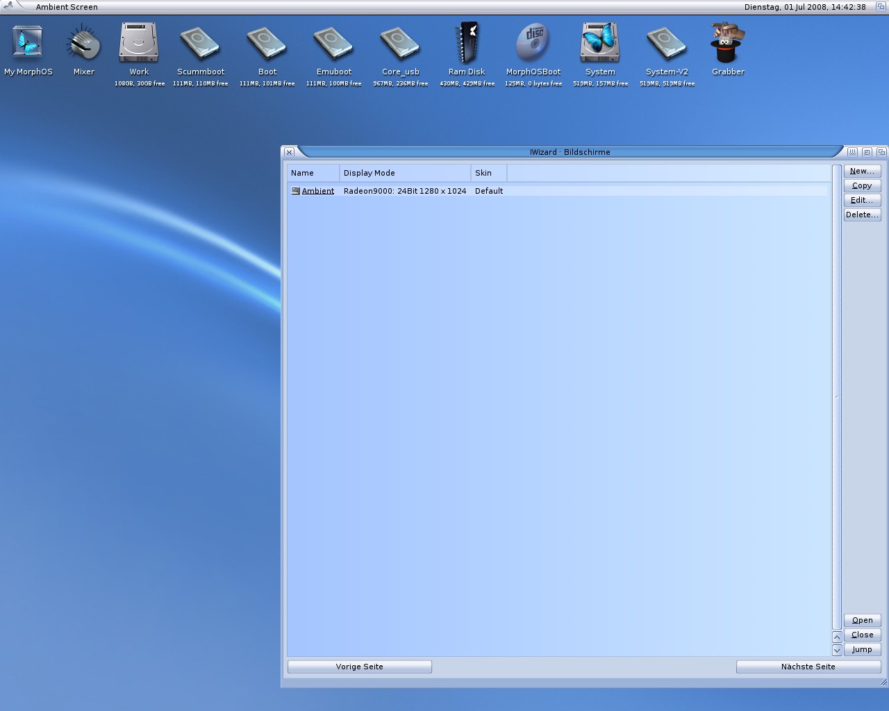

    Step three
    This is the well known screenmode tool from CGX.
    What I found rather strange is that Ambient was defined in 640x480 (not in my screenshot, was made after I configured it), however the screen res was 1600x1200 (the max possible resolution on my poor 17 Zoll CRT)
    Anyway, that resolution was much to high for my taste, so I simply choose a lower resolution.
    As I mentioned earlier, I was able to crash the System here, so be careful (dunno how that happend, this time everything went fine)
    If you aren`t as Impatient as I was, you can also define additional Screens, on my 1.4.5 Setup I have several defined Screenmodes for various Applications.
    Step four

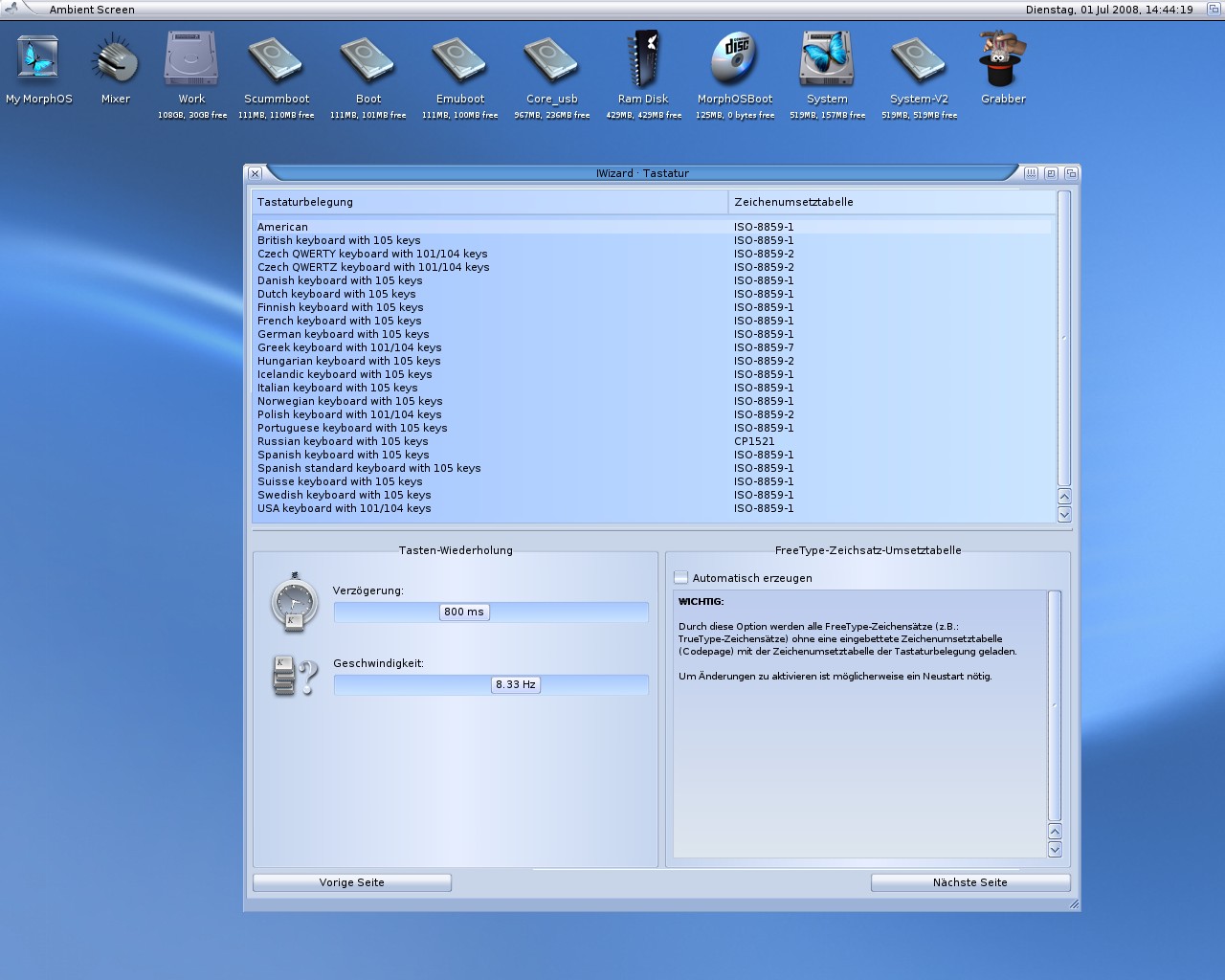

    configure your Keyboard Settings here, should be clear, Interesting might be the switch on the right, If you enable it, all your Freetype Fonts without embedded codepage will be loaded with your keyboards codepage.

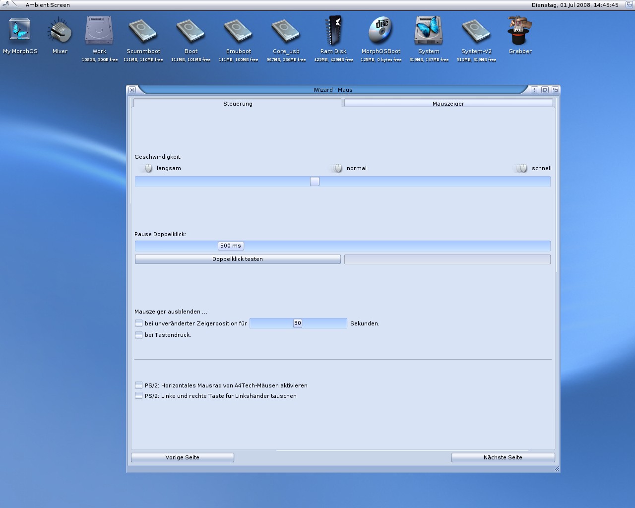

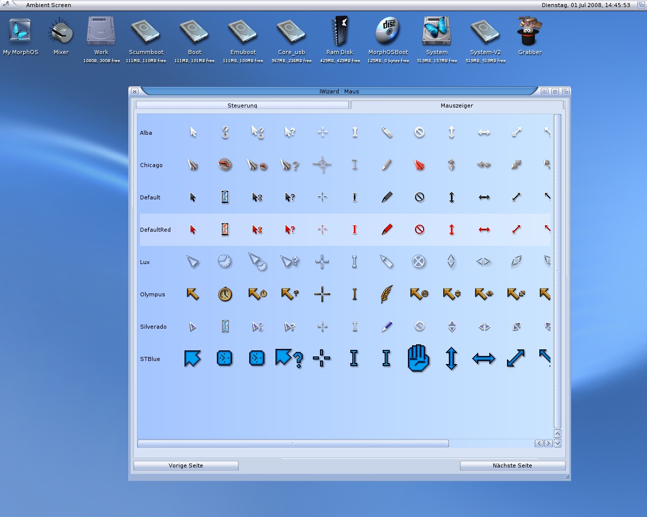

    The usual config stuff for your Mouse.
    Decide if you want your Pointer to disappear for certain actions, and for all you lefthanders out there still using a ps2 mouse, you can also change your mousbuttons (USB Mouse Lefthanders might want to configure that within Poseidon)
    Step six part two
    Tadaaaaa new eyecandy ;)
    Select your prefered pointer theme here.

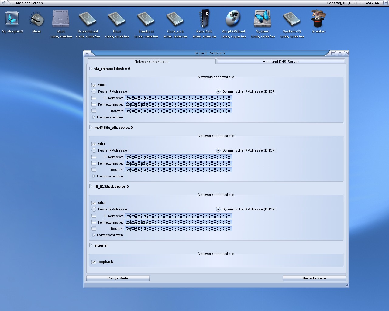

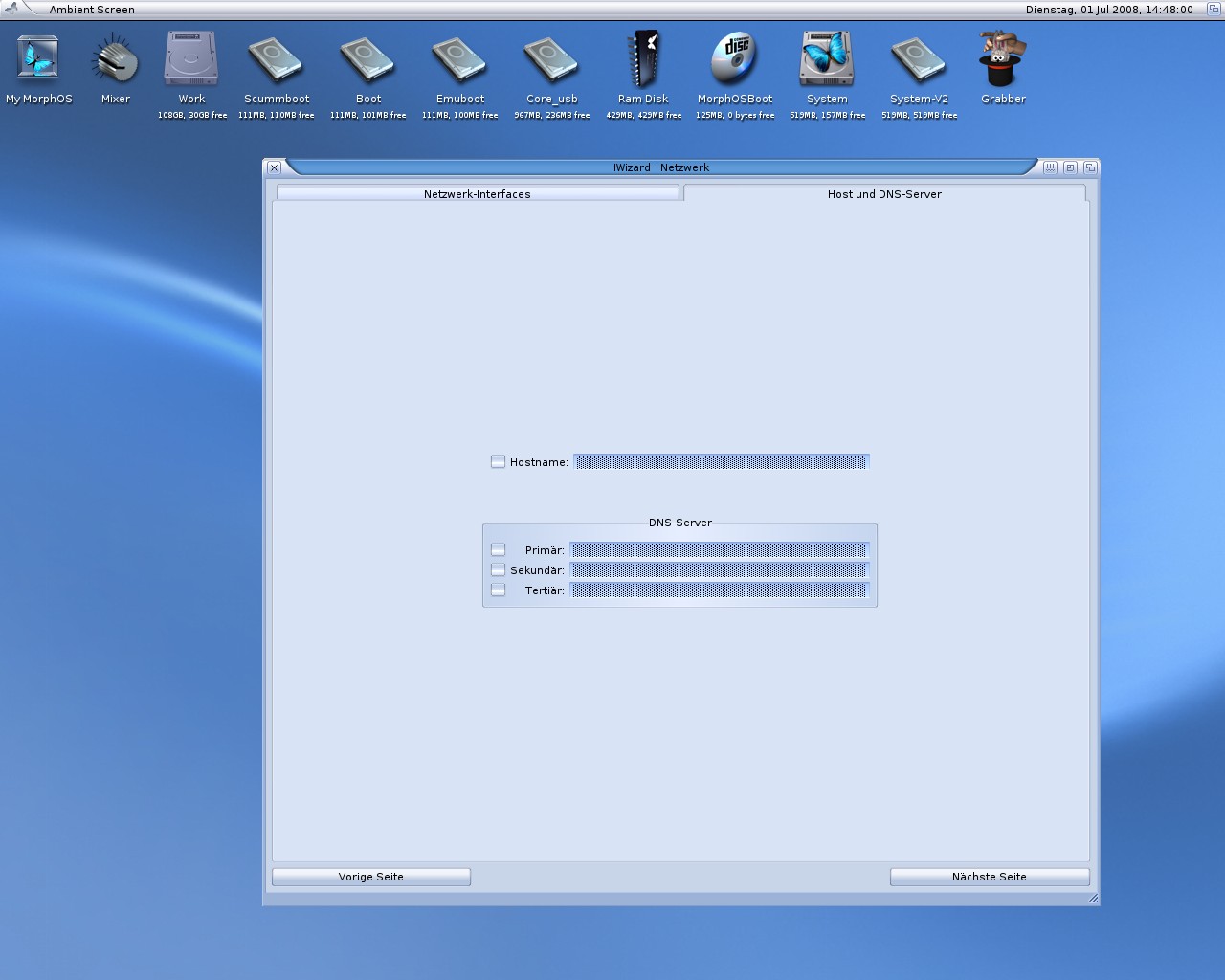

    The time where we had to explain why our favourite OS has no TCP Stack, is finally over: Ladies and Gentlemans, I proudly present you Netstack (or rather its configuration window)!
    On the first page, simply select your network interface and decide whether you want it to use with a static or a dynamic IP.
    Step seven part two
    On the second page you should configure your machines host name and please don`t forget to add a valid dns server if you are using a router (That said, does anyone know whether Netstack supports DSL via PPPoE? Not that I care much, I am happy with my router, just curious)
    Step eight

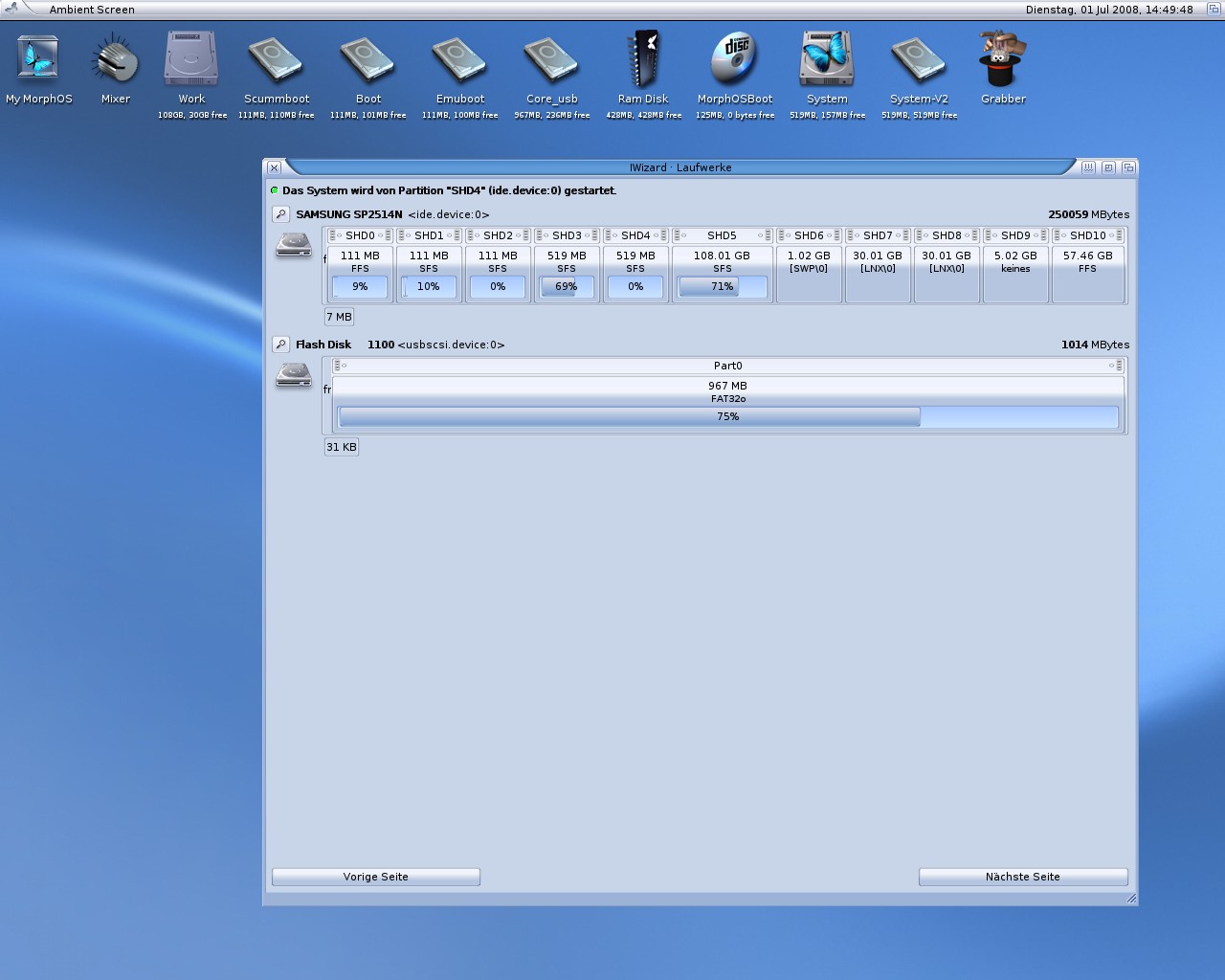

    Here you find the allnew Partition Tool. Noticed how it even detected my fat32 formated USB Stick? Nice ;)
    (And yes I like to partiton my harddisk ;) )
    As sfs resize didn`t fully work for me (for whatever reason, it decided that i just can resize the partiton down to 700 something mb although just 400 something where used. And yes, i did defrag before)
    I decided to split my 1 GB bootpartition in 2 smaller ones. I selected the former bootpartiton, here I was able to set it to a smaller size, selected the new empty partition selected sfs, and done.
    Please note, this is the point where you *will* destroy your previous partition and all your data. I did a backup before, please do the same!
    Oh and don`t forget to make it bootable!

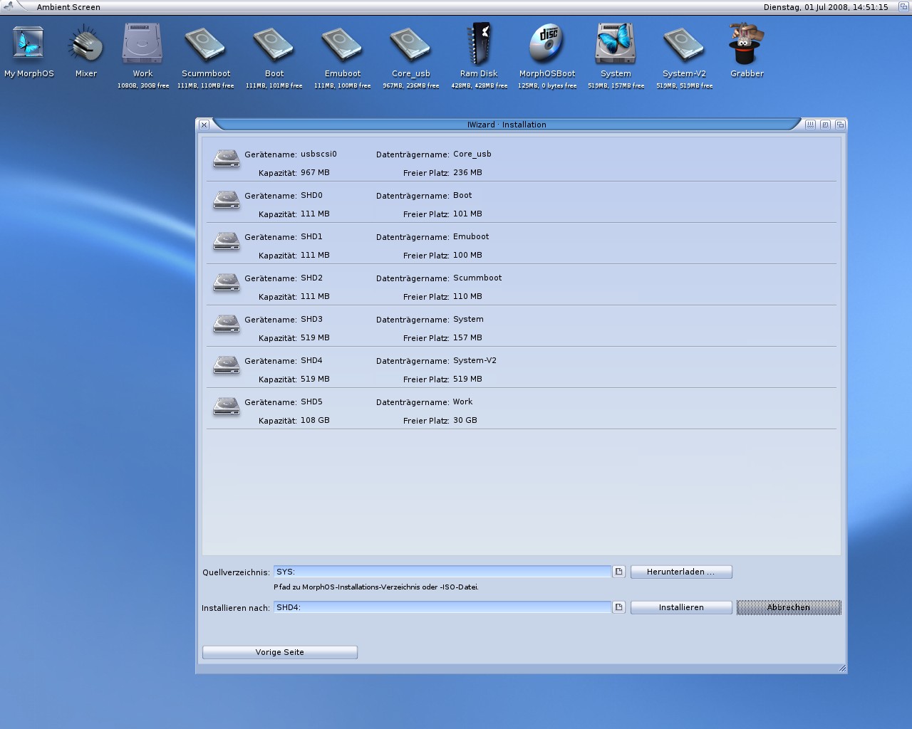

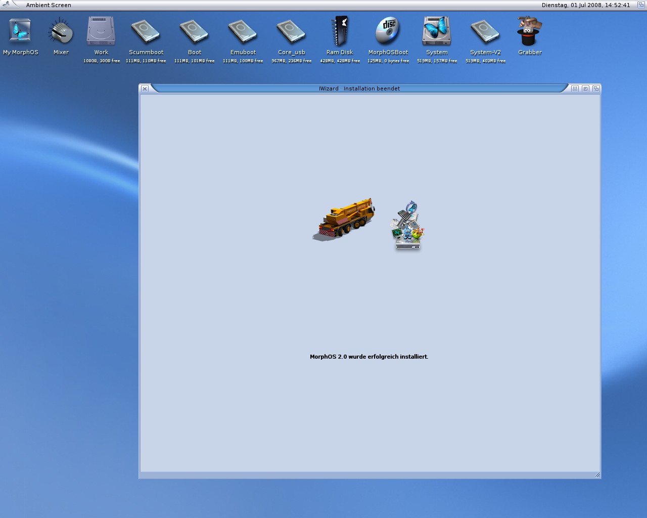

    Step nine
    Phew, we are finally there, select the device where you want to install MorphOS V2.
    Remember the hint from the welcome screen? Instead of pointing your Source to your cd you can point it to your allready downloaded Isofile (and this way be sure that everything will be copied, last time I had to install a windows machine i found out that one single file was not copied due the cd beeing scratched....) and even better you can also download your installation image (might be handy for the efika, since I had the Iso allready and I didn`t want to cause more traffic, I didn`t try that feature)
    Step ten
    Yeeeeehaaw we`re through ;) If everything went right, you should see that nice "done" Picture :)

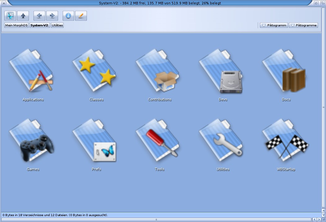

    If you want to use your small bootpartition you should now copy your v2 boot image (found in your new morphos partiton) to your boot partiton, please don`t forget to rename it first.
    Now open your bootmenu with a texteditor (btw MorphOS V2 has one in the Utilities drawer) and add a new entry, simply have a look on the old one for MorphOS V1 (don`t forget that two entries are neccesary)
    now adapt the right paths and for morphos v2 add the parameter "bootdevice=shdxx" where shdxx stands for your MorphOS V2 Partition.
    This is how it looks for me

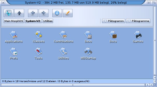

    Have a look into the contributions/Filesystempack drawer
    Execute both install scripts and then open the mounter tool (sys:tools)
    Now you can easily activate your ext2/3 SGI or if you have, ntfs partition.
    very cool and very easy.

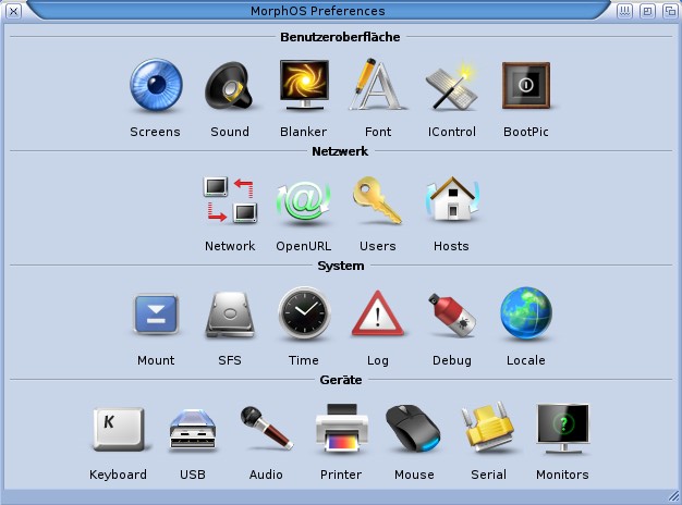

    I know, the Devs will hate me for that ;) (IIRC they don`t like comparisons like
    "Uh that looks just like OS xyz") however, /me thinks that the new Preferences
    Window looks very OS X like ;)
    But I like it, looks very polished.

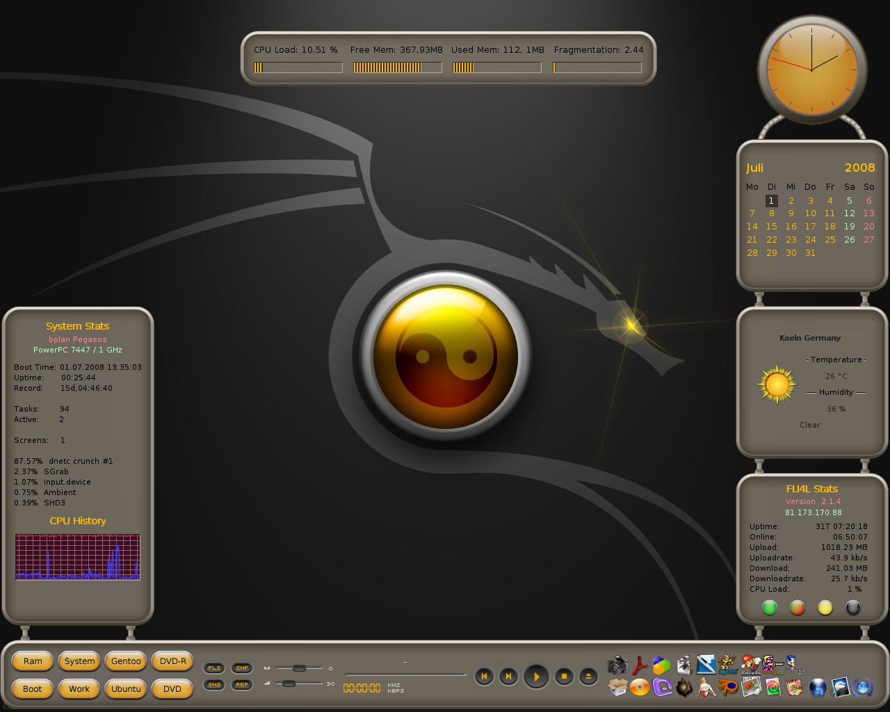

    21:20
    right before the next timeout, I added the 3d bootparameter to the script.
    Well what can I say, although no 3D Switcher is yet available, it nevertheless brings additional
    eyecandy to your System ;)
    layers3d

    Thanks to Q-Box (No really they named that Tip of the day tool really Q(uestion)Box ;) )
    I found a nice Ambient Feature.
    On a opend Window, press ctrl and scroll with your mousewheel.
    That is the result
    normal Icon Size
    small Icon Size
    huge Icon Size
    Icon resize on the fly, is nice isn`t it? ;)
