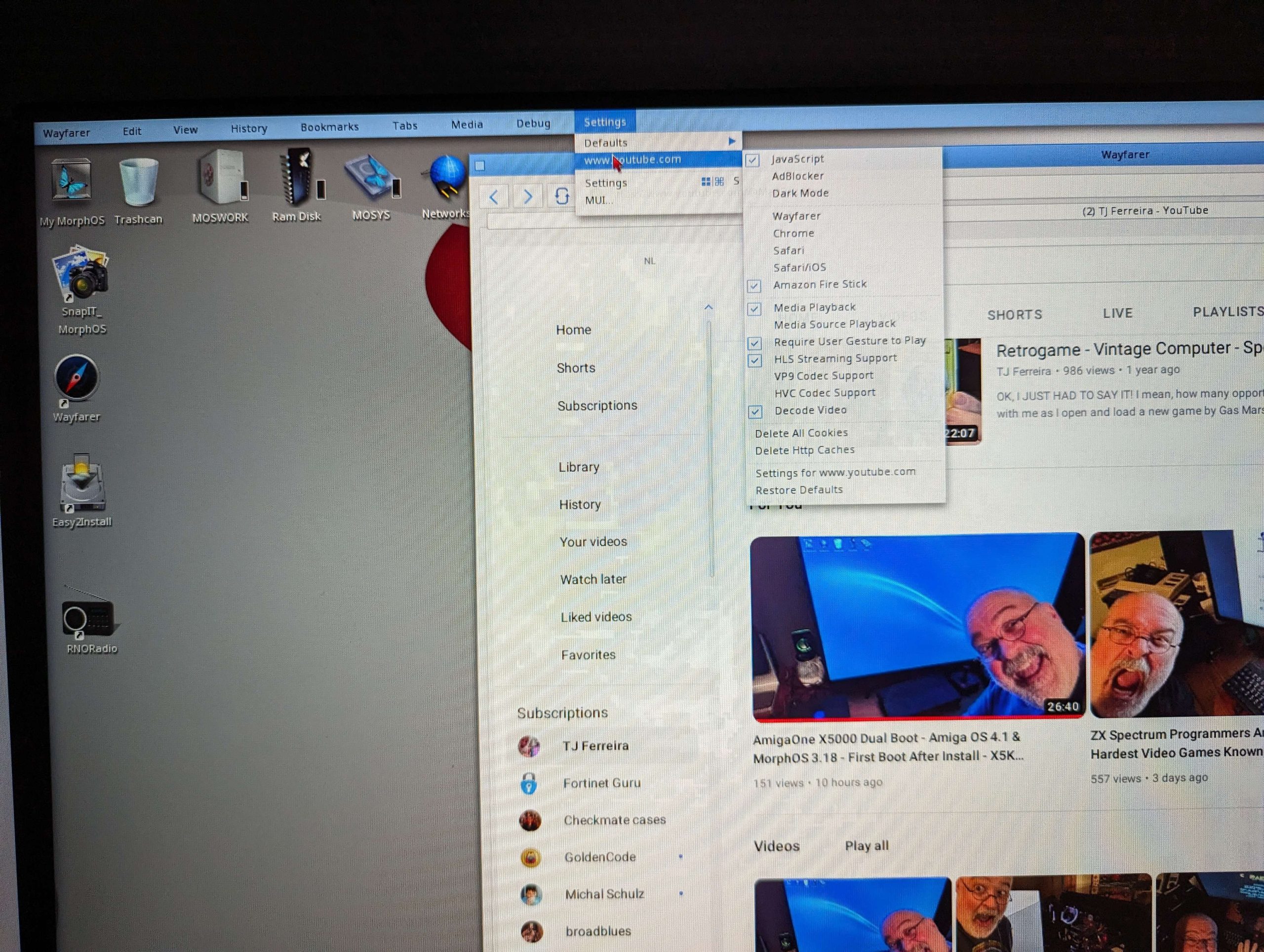

    As far as Wayfarer, you are way off speeds right now that I'm seeing. I can't believe it's just the G5 at this point, so here is what I might suggest:
    1. Install the latest wayfarer and it will auto update whenever a new release comes out. Jacek really has all that stuff dialed in. I would bet version 7.2 is faster than the 6.x with a base 3.18 install.
    2. Change the in memory cache to 'balanced' under settings in wayfarer and also crank up the memory for it.
    3. Turn on Caching, especially since your using spinny disks. That is done under System with the super dude icon.
    4. Try different settings in wayfarer to spoof as other browsers.
    5. Jacek posted that using a proxy definitely improves performance. I haven't done this yet, however.
    6. You may even want to increase buffers on the partition, not sure if that will gain much though...
    Again, my setup is MUCH faster than what you are showing thus far. So you have speed to find at this point, keep looking. Youtube comes right up pretty much and I can click and play videos with no issues.

  • »23.01.24 - 14:54
    Posts: 54 from 2020/10/11
    You can try these settings in wayfarer on your X5000
    [ Edited by Skateman 23.01.2024 - 17:21 ]

  • »23.01.24 - 16:19
    Posts: 3336 from 2003/3/5
    These are not the right settings for Youtube. You are using wrong user-agent for the URL and have media source disabled.
