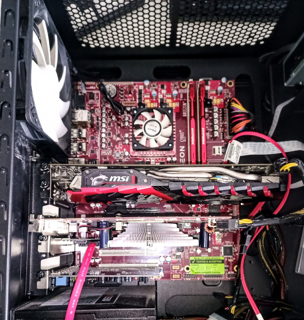

    Posts: 38 from 2020/10/11
    > there is no easy way to put a 2nd x16 PCIe card into an X5000
    > because there is only a single x16 slot
    Indeed. ATI/AMD Fire* PCIe x1 cards may be the easy way to go, then.
    > PCIe Riser [...] leads to other mechanical problems.
    This thread has examples of PCIe x1-to-x16 risers and PCIe x4-to-x16 cables that seem to work well with PCIe x16 graphics cards in the X5000 standard case.
    > it would be nice to have the software fixed to make it possible
    Absolutely.
    Would be great if we can use MorphOS 3.17 on our X5000 without the card swap hussle :-)
    I have been using the X4 to X16 cable now for the graphics cards as you can now see in the second page of the thread you refer to. That cable costs around 25 - 20 euros and the X4 connector fits nicely under the cooling fan of the Primany graphics card.
    https://forum.hyperion-entertainment.com/viewtopic.php?p=55237#p55237
  • »27.04.22 - 15:40
    Posts: 12461 from 2003/5/22
    Yes, that's what I referred to in my comment that I wrote here some hours after you posted those pictures to the Hyperion forum. In fact, the second page was already complete by then ;-)
  • »27.04.22 - 17:18
    kas1e
    Posts: 97 from 2005/10/31
    @all
    After mos3.17 out, can anyone point me on the tested PCIEx1<->PCIx16 adapter which tested on x5000 and works ?
  • »02.05.22 - 03:12
    bigfoot
    Posts: 510 from 2003/4/11
    Any adaptor/riser should work. I got this one for testing.
    I rarely log in to MorphZone which means that I often miss private messages sent on here. If you wish to contact me, please email me at [username]@asgaard.morphos-team.net, where [username] is my username here on MorphZone.
  • »02.05.22 - 04:55
    Yeah!
    I have the following X5000 setup running
    PCIeX16 slot RX570 for use with AmigaOS4.1
    PcieX4 slot FirePro V3700 Linux / MorphOS
    I have used a PCIe X1 riser and PCIe X4 to X16 cable, and both work perfectly.
    Thanks Morphos Team!!
    [ Edited by Skateman 06.05.2022 - 20:39 ]
  • »03.05.22 - 17:01

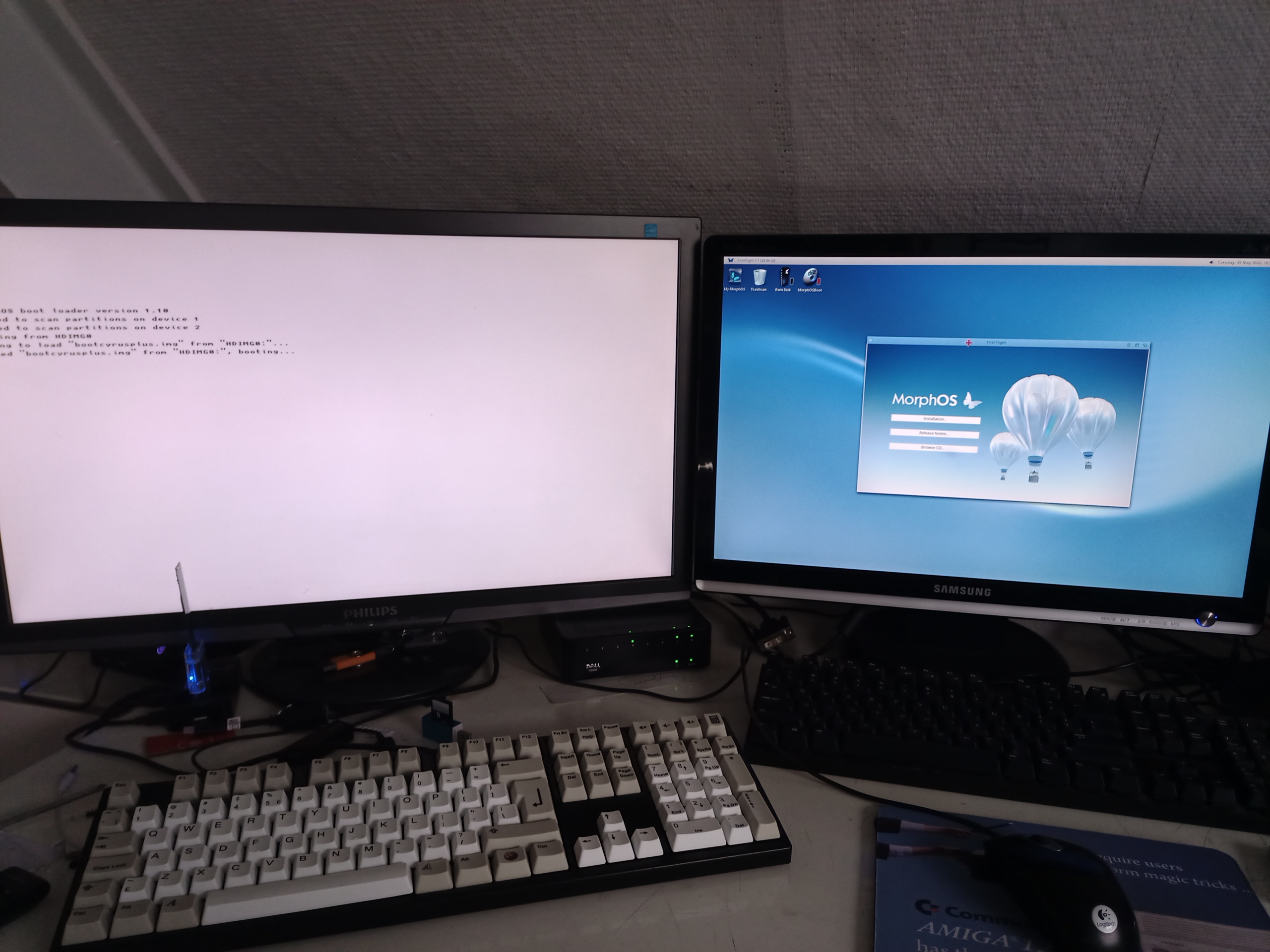

    Posts: 10 from 2021/3/11
    I am a new X5000 user and would need help
    I was able to install Linux OS4.1 and MorphOS but only if the video card is mounted in the PCI16x slot
    I bought a PCI1x to PCI16x adapter to mount a second graphics card but I have no video output.
    The cards I have tried in the converter are
    Radeo 1950 pro 512 mb memory
    Radeon 6670 1g memory
    but they work great in the PCI16x slot
    to make the converter work I have to change something in the firmware My firmware is dated 2018-10-05
    thank you
    Greetings Gianni
  • »08.05.22 - 11:57
    Thanks 1000
    Problem solved with MorphOS
    Mounted two monitors instead of one with two inputs
    If I don't disturb a cotesia yet
    With linux I still can't
    I changed the Xorg.conf device from 0 to 1 but I can't change anything
    The sequence I use for booting is the following
    setenv linuxboot
    setenv bootargs dev = / dev / sda2
    load sata 1: 1 1000000 uImage-5.18
    load sata 1: 1 2000000 cyrus-p5020.dtb
    bootm 1000000 - 2000000
    To get the video on the card mounted on the PCIe-1x do I have to add something?
    because this is how only the card mounted on the PCIe-16x works
    greetings Gianni
