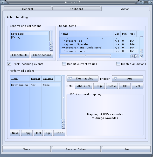

    Im having couple of problems, first my keyboard layout. Im using Apple Pro keyboard and finnish keymap, http://frontype.com/keyboarding/540px-Computer-keyboard-Sweden.svg.png the keys in red aren't functioning at all. I guess this is a Apple keyboard related? Is there a way to fix this? I really need the tilde key.

    1. Open System Settings->USB go to Devices and find your keyboard. The prefs aren't that obvious to use, but once you get to the third tab (afair), there'll be a switch called 'Show current value' or 'Sample'. Enable these and press the keys that don't work. This should show you whether they are recognized at all or not. Once you know which keys are these, you can change the key bindings for them.

    Ok, so the keys work. But they are binded to blank and as far as I can tell, there's no correct key in the list. So they are missing from the keymap. Is there any working tool to set them? KeyMorpher doesn't work.

    It looks like this:
    As you can see, there's no key assigned for 0x0C and 0x1B, they should be the keys in red in my first posting.

    Well... that seems wrong indeed. Let's look at the third tab instead: it should generally look like this. If it doesn't, change the peformed action to Keymapping. If that's already set and yet the key doesn't work, you'll have to add two actions looking like this and this.

    No go. Even the action tab is missing the correct key. action.jpg :/

    Which keymap do you have selected in Preferences->Keyboard? Try switching to English and restart the prefs application... Perhaps it's a bug in the keyboard definition.

    I have finnish keymap selected, since I have a finnish keyboad. Selecting swedish didn't make any difference (they are the same anyway). I was able to test a Dell Finnish 105 key USB keyboard and the dead keys didn't work with it either. So, atleast with finnish keyboard, the dead keys are broken. Should i report a bug?
    Edit. Aha, the dead keys are working... sort of. The behaviour is not what I'd expect though. The keys work in combination with other keys (like dead keys should) but not with the key itself. With KeyMorph I was able to see, that I can have tilde with alt + shift + "section mark" in my keymap. Is this intended behaviour?
