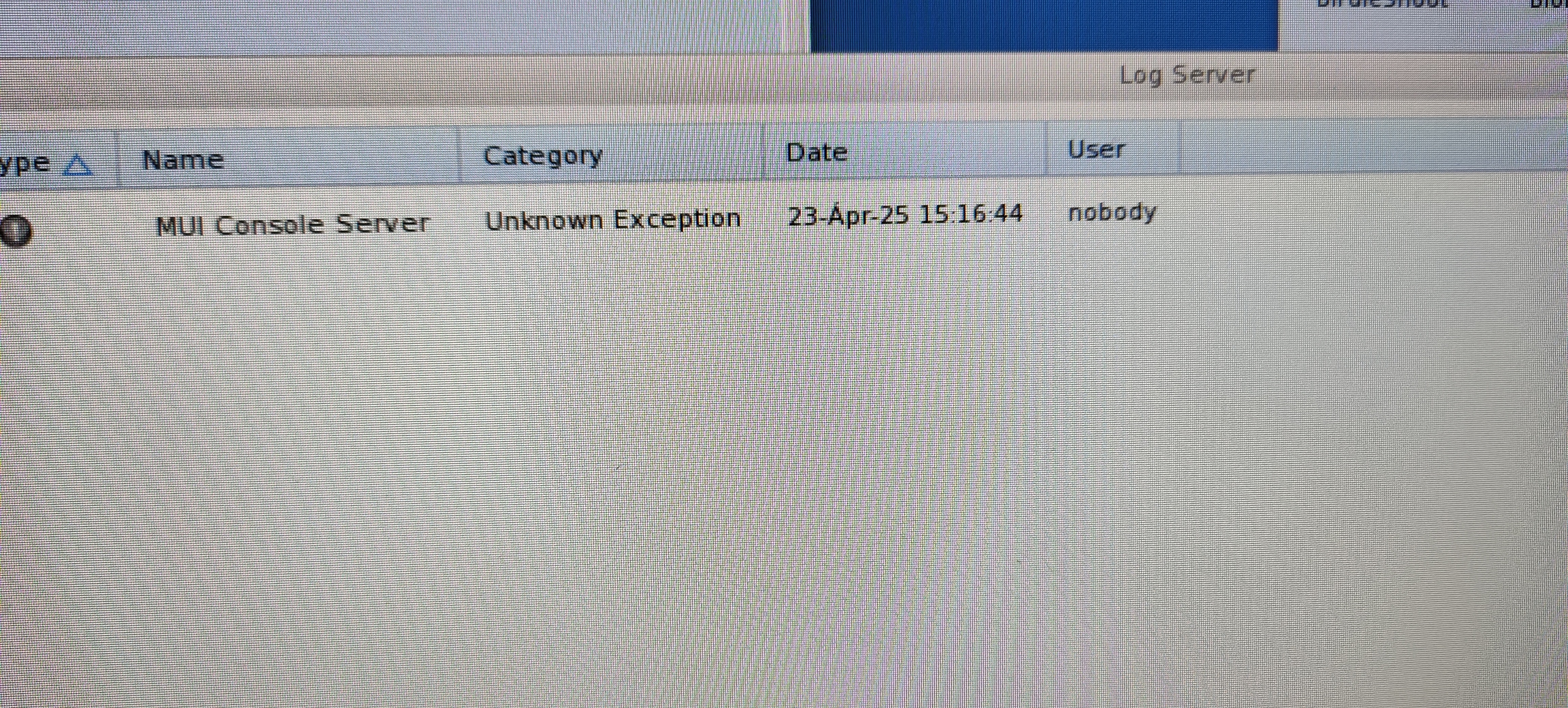

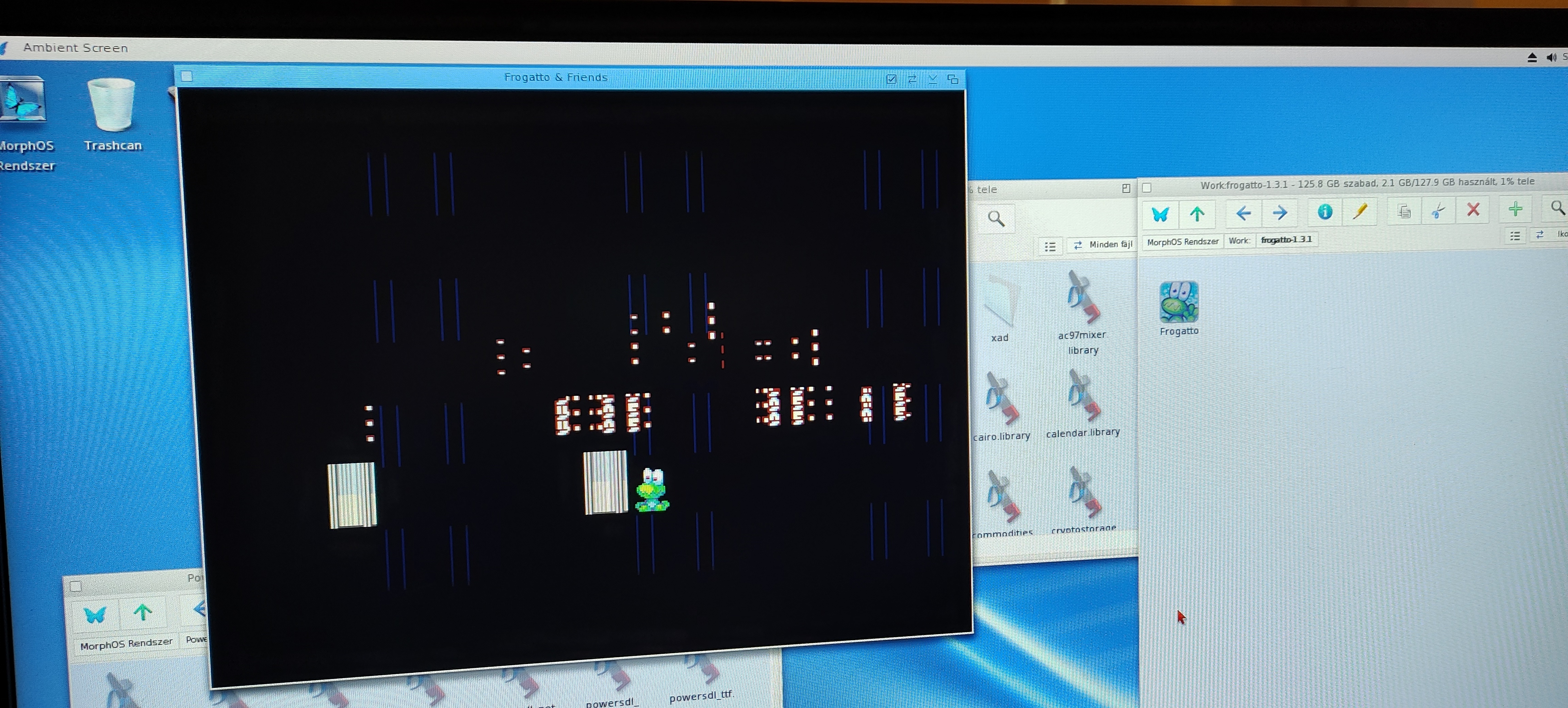

    The internet is finally working, but there are some problems
    I downloaded and installed the latest SDL package
    However, several games are message missing the powersdl.library etc. I solved this by manually copying them to the Morphos/Libs directory
    I don't understand why the installer didn't do this?
    Some games are so slow they are unplayable
    I don't understand what kind of machine you need to run games at normal speed?
    For example, the game Speed ​​Dream is so choppy that it's impossible to play at all.
    System freezes are very common and can only be resolved by turning the machine off and on.
    SDl based games have the most problems
    this was already the case back then but I thought they had fixed it since then
    either the system freezes on startup or the graphics are displayed incorrectly
    unfortunately I have no idea why
    The image shows the faulty graphics in one of the games.
    MTkwNzU1OQ.jpg[/img]
    Error message
    [img]MTkwNzU2MA.jpg[/img][img]
    [ Edited by Krisz 23.04.2025 - 14:47 ]

  • man
    man
    Posts: 136 from 2019/11/11
    with the update tiny gl some games d'ont work correctly
    frogato work with morphos 3.15 not after
    they certainly change later for some games

    Posts: 2585 from 2003/2/24
    Newer SDL can easily coexist with older ones and as these are normally link libraries or DLLs there is simply no real need to keep backwards compatibility.
  • »23.04.25 - 17:03

    Posts: 12575 from 2003/5/22
    > Newer releases of SDL [...] should be written in a way
    > that is backwards compatible
    That's not even the case on mainstream platforms, so how should it on MorphOS?
    "SDL 2.0 [...] was a major departure from previous versions, [...] breaking backwards-compatibility [...]. [...] SDL 2.0 is a major update to the SDL 1.2 codebase with a different, not backwards-compatible API."
    https://en.wikipedia.org/wiki/Simple_DirectMedia_Layer
    > So games that work well now may not work in the future
    As Kronos wrote, games that use SDL1 use exactly that and simply ignore newer installed versions, and vice versa for games that use SDL2/SDL3.
  • »23.04.25 - 22:35

    connor
    Posts: 650 from 2007/7/29
    Error message
    Which installer exactly? The games usually don’t have installers. You install powersdl and the libraries once and then all programs who can use them.
    SDL programs and games are slow in general and most of them are ports from other platforms, maybe only very few progrms just written for MorphOS. On the other platforms they have much better hardware and there they run at good speed. But we only have these old G4 and G5 (or even slower), so they can’t run fast like on current Intel or AMD. PowerMacs are retro hardware, don’t forget that.
    What exactly freezes? Which programs freeze? I experience MorphOS quite stable, at least for an OS without memory protection. I often use it with many programs for many hours without reboot. What you wrote is your experience is based on games only, right? Or do you have any programs that are unstable? If you find errors you can always write the authors and describe your problems. Then they can fix them.
  • »24.04.25 - 09:08

    Krisz wrote:
    I'm aware that it's old hardware, but I don't understand why they port games that no one will be able to use because they run slowly.
    Challenge accepted. Name your titles.
  • »24.04.25 - 11:53
    connor
    Krisz wrote:
    So far I've only tried games and had a lot of problems with them
    e.g. today I played a game called Hurrican for a few minutes and after I quit it the system froze so I couldn't do anything except turn the computer off and back on
    Only tinygl and sdl are installed
    I don't know what's causing the freezes
    The browser also froze today for no reason
    The registration fee wouldn't be expensive if the system worked properly
    I don't think it's just me who has freeze and it works perfectly for everyone else!
    Moreover, this is the third machine I've used MOSt on. My very first machine was a Pegasos2 which ran games pretty well at the time, but there were also freezes.
    Sending an error message to the developers is impossible because the system completely freezes
    there are times when the mouse pointer moves but doesn't respond to anything no matter how much I click on it
    I am also aware that the MorphOS team does not have the same financial support as Win or MacOS!
    so it is natural that the possibility of errors is greater than on other systems
    I don't want to blame MOS, I just want to find a solution that would reduce the freezes and allow me to play older games without any problems sometimes.
    Details would be needed to find out what is wrong with your system. The programs that you run, which action you do exactly that makes them crash, the log from the LogTool and all that. “I don't know what's causing the freezes” – we also not. We do not even see your computer. So details will help. Many users are using MorphOS regularly and for hours. Music, graphics, text, internet (Wayfarer, Iris), calender (Poly Orga) and many many more. I often can run the compouter all day without a single reboot. Otherwise I would not use it. And I use most of the programs that are on the CD and many many more from Aminet and MorphOS Storage.
    Did you start with a fresh MorphOS install on the G5? Because you mentioned that you also connected an old disk to it. Maybe the problems come from there.
    I don’t game, but I think others are doing it and it does not freeze for everyone. I propose you only use one title at a time and see if the system behaves stable. If it crashes then you know which program or game crashes. Then you can answer the first of the questions from above here.
    Also for applications, tools. Firest, only use the ones from the CD, no external software. The ones on the CD must be stable.
    If that is stable then check out system friendly software from Aminet or MorphOS Storage. Start only one at a time and use it for the half hour that you have. Maybe repeat it next time after you rebooted. Many of us are using the programs and they do not crash al lthe time. So there might be something odd in your system. Maybe also the RAM. Did you check it is correct? Or do you have other modules to try? OR did you use the system with MacOS? Is it stable there? If you boot from the CD and run all the programs that are on the CD only, does it also freeze? Where exactly?
    The error sending report works, so this more speaks that something is very odd with your system.
    Many more questions to answer next to the unanswered from above 😊
    THen we can hopefully help you.

    Krisz
    Posts: 154 from 2023/3/22
    Thanks everyone for the replies
    I'll try to answer all questions
    so
    I used to use this G5 mac with Mac 10.5.8 and I played several games on it
    including Doom3 and it worked perfectly
    There were no freezes and no problems with speed!
    I wouldn't dare try Doom3 on MorphOs
    Among the ported games, for example, I tried a game called Speed ​​Dreams, which stutters so much that it's impossible to play.
    That's why I asked why they port games that can't even be played on this system
    a game of this caliber can easily be played on this machine under MacOs!
    I download all applications from the official site https://www.morphos-storage.net
    The system has the option to enable double and triple buffering, which is active for me
    I don't know if this is harmful when running games
    I know that normally this option should give me smoother gameplay, but I read somewhere that it can cause problems with MOS systems.
    SDL games are horribly unstable anyway
    Most of them can't even be set to normal fullscreen mode
    or the image is displayed incorrectly
    there are 2ds SDL games that have simple graphics and still stutter
    When I use the system more I will be able to write more about the bugs but unfortunately I am starting to lose interest in it
    I used to love my power Amiga and Workbench, everything was so much simpler there
    I installed everything
    SDL,TinyGL etc. I don't know what else I can do to make it work normally?
  • »25.04.25 - 04:27
