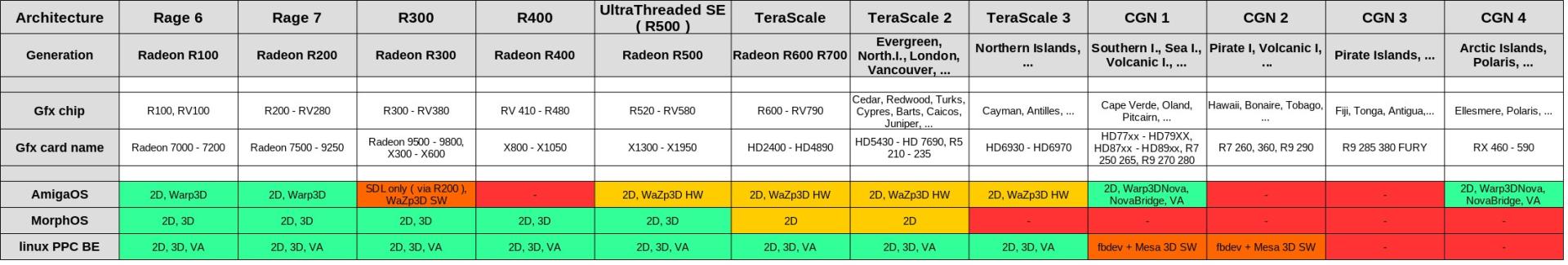

    At least in terms of 3D-supported PCIe cards, there's no GPU generation overlap between MorphOS/Linux and OS4:
    - MorphOS: R500 (and TeraScale2 (R800 and R900 minus RV970) with ninth beta TinyGL)
    - Linux: R500, TeraScale1 (R600/R700), TeraScale2 (R800 and R900 minus RV970), TeraScale3 (RV970)
    - OS4: GCN1, GCN4
    So for <OS4> AND (<MorphOS> OR <Linux>), you'd need to have 2 graphics cards in your X5000:

    I thought I explained it well in easy enough terms. Seems I didn't. So another try:
    There is no such card that does what you want. There is for MorphOS and Linux, but as soon as OS4 comes into play, the amount of cards that do what you want turns to 0, zero, nil, zilch, nought. That's why the guide on amiganews.de was written in the first place, not because it would be fun to have 2 graphics cards in the system just for the sake of it.

    as Andreas said, it is impossible to have one card with 3D acceleration on MorphOS, AmigaOS and linux.
    look here:
    AmigaNG – kompatabilita HW s AmigaOS, MorphOS a linux ( Czech )
    Amiga NG - compatibilité matérielle avec AmigaOS 4, MorphOS et Linux ( French )
    Abov are articles about hw compatibility. It explains why you need more cards. Use google translate.
    If you really want only one graphics card, it is possible, but you shoud resign to 3D ( even on 2D ) on some systems.

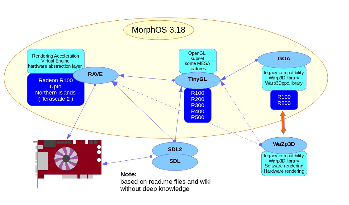

    Your MorphOS graphics system diagram has some severe flaws:
    - the "RAVE" field must be changed to "CyberGraphX" (or "CGX")
    - "RAVE" must be another field with an arrow to "CGX"
    - the "GOA" arrow must go to "RAVE", not to "TinyGL"
    - "R100" and "R200" must be moved from "GOA" to "RAVE"
    - "R100" must be deleted from "TinyGL"
    - another "TinyGL (old)" field may be created with an arrow to "RAVE"
    You probably noticed the phrase "based on read.me and wiki without deep knowledge" in diagram.
    MorphOS documentation is not too verbose about graphics system.
    I would very much appreciate it if you could fix the graph and put it for example to wiki or libraryand I can use it.
    Indeed, I did. You may see my hints as an attempt to deepen that knowledge :-)
    Sorry, won't do. I think the author of the Amiga3dapi.svg on Wikipedia is aware of its flaws, seeing as he corrected some of them after I reported them (#7), but interestingly only some of the AROS/AmigaOS-related ones and none of the MorphOS-related ones. I won't speculate as to the author's motive of keeping all MorphOS-related flaws in the diagram, though. Now that you are aware of the flaws in yours, you may decide to act on it or leave it as it is. It's your choice and responsibility. I think I did my "duty", and I'm very much aware that we probably won't agree on this ;-)
    Where do this Morphos graphics system diagram come? I never saw or heard of it.I really don't understand.
    In reality I am not an expert in AmigaNG/X5000 hardware,excuse me for this and my misunderstanding on all this thread.
    [ Edited by bearerofthetorch 14.02.2025 - 15:33 ]
  • »14.02.25 - 14:24
    Posts: 478 from 2019/5/9
    @bearerofthetorch:
    look at least at this table.
    If you want to play 3D games like DOOM3, you need 3D compatible card. For example:
    X1950 for MorphOS and linux and RX 580 for AmigaOS. I.e. at least two cards.
    Otherwise you can do some compromise. If you really want only one card, you have to prioritize your system:
    MorphOS like main system - use X1950, 3D for linux, but 2D only on AmigaOS
    Look at "With 3D hardware acceleration:" part
    AmigaOS like main system - use Southern Island, i.e. HD77xx-79xx or R9 280, linux also works here with double buffer framebuffer, but MorphOS not works.
    or use Polaris RX 550 - 580 card, very powerful, AmigaOS only. No linux, no MorphOS.
    AmigaOS 3D cards.
    linux like main system - use HD6970, with no MorphOS and 2D only AmigaOS.
    Or HD 6870 with 2D on MorphOS and 2D AmigaOS.
    After bigfoot finishes his TinyGL update, best single will be something like HD 6870 with 3D on MorphOS + linux and 2D on AmigaOS. It will be great, but there are no fixed term of issue.
    Not forgot that for all newer AmigaOS cards you also need extra drivers - you can find them in Sam460 article.

    sailor wrote:
    @bearerofthetorch:
    AmigaOS 3D cards.
    I want to use my Radeon 5450 HD and add another 2D-3D for Morphos specially and of course for Fienix.There are so many models that I don't know really.

    It's not "the 2 gfx cards". Use sailor's table linked to in comment #16, look therein in "Architecture" row for "R500" and "CGN4" (which should really be "GCN4"), respectively, and then look below in the respective cells in the "Gfx card name" row. This reveals the possible graphics cards.
