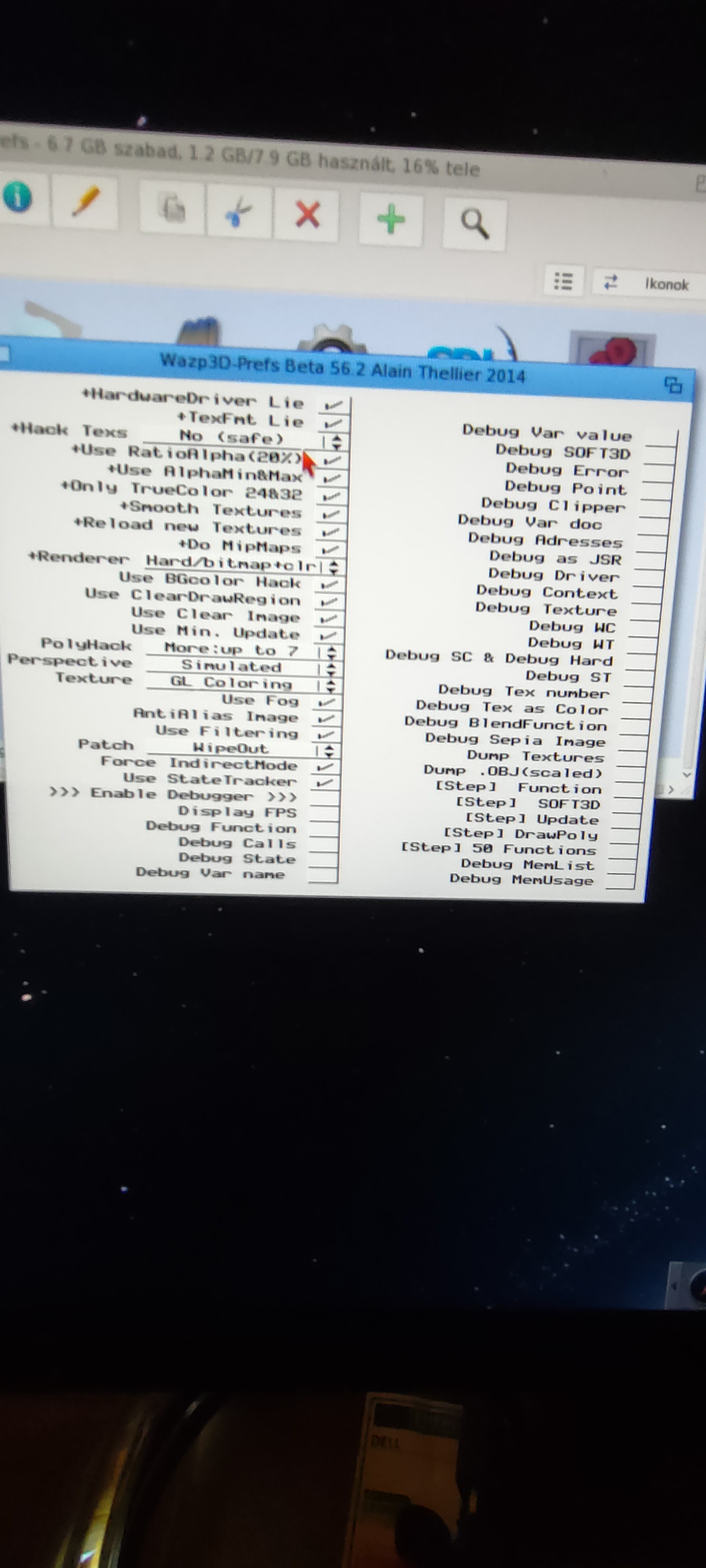

    Krisz wrote:
    Unfortunately, I haven't been able to configure wazp3d yet because neither shogo nor wipeout are working properly.
    For Wipeout 2097 use:
    +HardwareDriver Lie: check
    +TexFmt Lie: check
    +Hack Texs: RGBA/RGB/ARGB
    +Use RatioAlpha(20%): check
    +Use AlphaMin&Max: check
    +Only Truecolor 24&32: check
    +Smooth Textures: check
    +Reload new Textures: check
    +Do MipMaps: check
    +Renderer: Hard/bitmap+clr
    Use BGColor Hack: check
    Use ClearDrawRegion: check
    Use Clear Image: check
    Use Min. Update: check
    PolyHack: More:up to 7
    Perspective: Simulated
    Texture: GL Coloring
    Use Fog: check
    Antialias Image: check
    Use Filtering: check
    Patch: WipeOut
    Force IndirectMode: check
    Use StateTracker: check.
    Apart from that, download and use MorphOS version of Wipeout launcher written by BigFoot.
    If game is complaining about missing .TGA files - assign wo2097: to PROGDIR:
    Wazp3d settings for Shogo are the same as above with slight modifications. Differences:
    +Smooth Textures: uncheck
    Use Fog: uncheck
    Patch: No
    if weapons change doesn't work, edit the font.config file and change the used Helvetica to some bitmap font found in your MorphOS install (like XCourier.font).

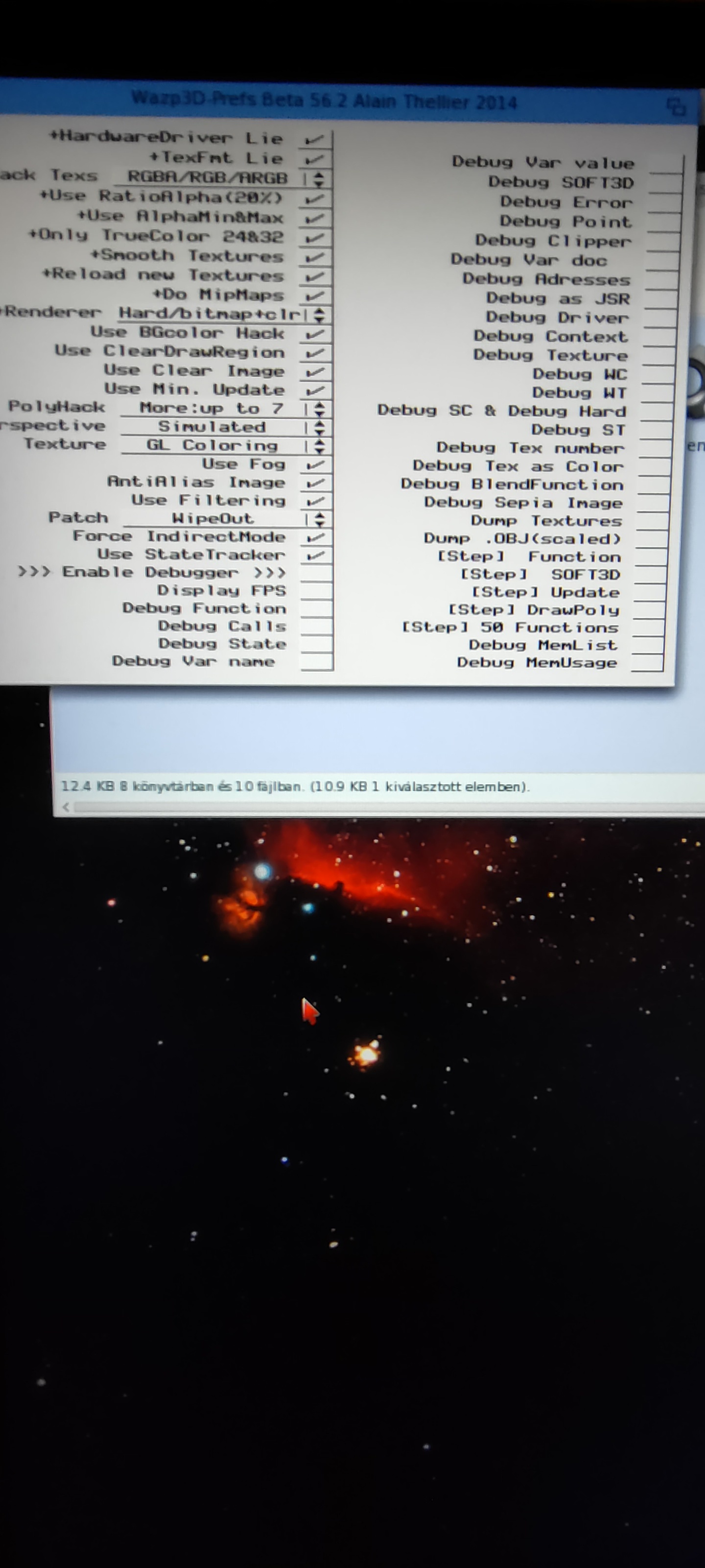

    Posts: 34 from 2013/6/20
    Hello
    You dont need +Reload new Textures: check
    as it is used to replace the existing textures with other files that you provide
    also
    are not needed as they are only used if +Renderer: soft
    Anyway it dont harm to let those flags on ;-)
    Most of the time Wazp3D's default settings are the best, only Renderer,Hack Texs, PolyHack are really important to make a program works
    Renderer: define how Wazp3D draw: by software cpu or use an hardware library
    Hack Texs: if ON the textures that the prog provide are directly used by Wazp3D so there is no textures allocated on the Wazp3D side meaning it will crash if the prog free textures on his side. This option economize loots of memory but if the prog crash dont use it
    Polyhack: if the prog want to draw a small tristrip or trifan then Wazp3D assume it is in fact a polygon so draw it as a polygon (=faster). If some drawing are deformed dont use it
    Alain Thellier - Wazp3D author
    [ Edited by thellier 02.05.2025 - 09:27 ]

    Krisz
    Posts: 154 from 2023/3/22
    thellier wrote:
    Hello
    also
    Thanks for the detailed description
    I first tried Shogo with the default settings, but the game menu was confusing and when the game started, the texture was wavy.Now I'll try these settings + what Koszer suggested and I'll write if it worked.

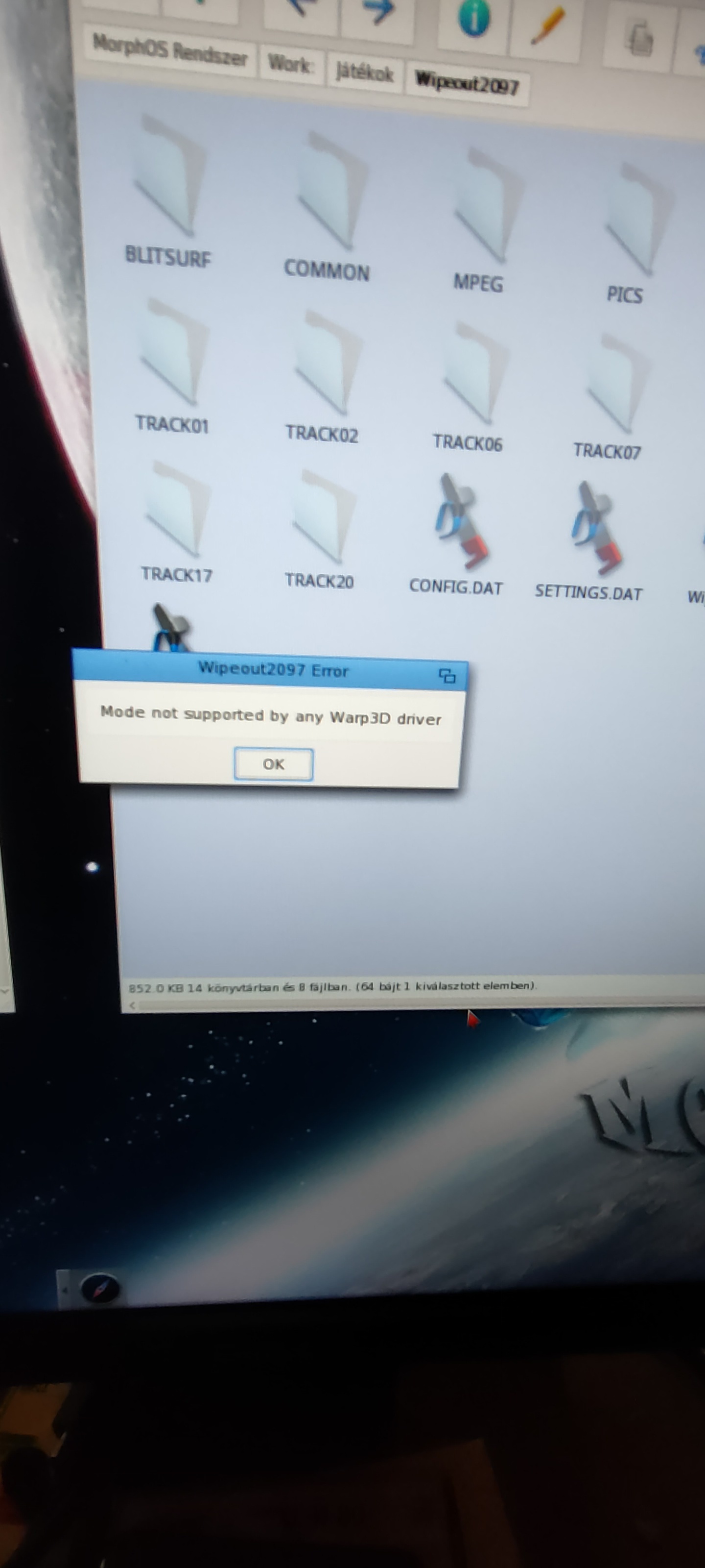

    koszer
    Posts: 1362 from 2004/2/8
    Krisz wrote:
    I tried the settings and the wipeout loader and the game won't start anymore :(
    same for both settings
    Please tell me just one thing:
    Why 16 bit?
  • »02.05.25 - 09:03

    Krisz
    koszer wrote:
    Please tell me just 1 thing:
    Why 16 bit?
    8 bits wouldn't be enough, and 24 bits makes no sense for such an old game
    at least that's what I thought
    Back when I played on Amiga, I still chose a 16-bit screen
    Then which screen mode is correct?

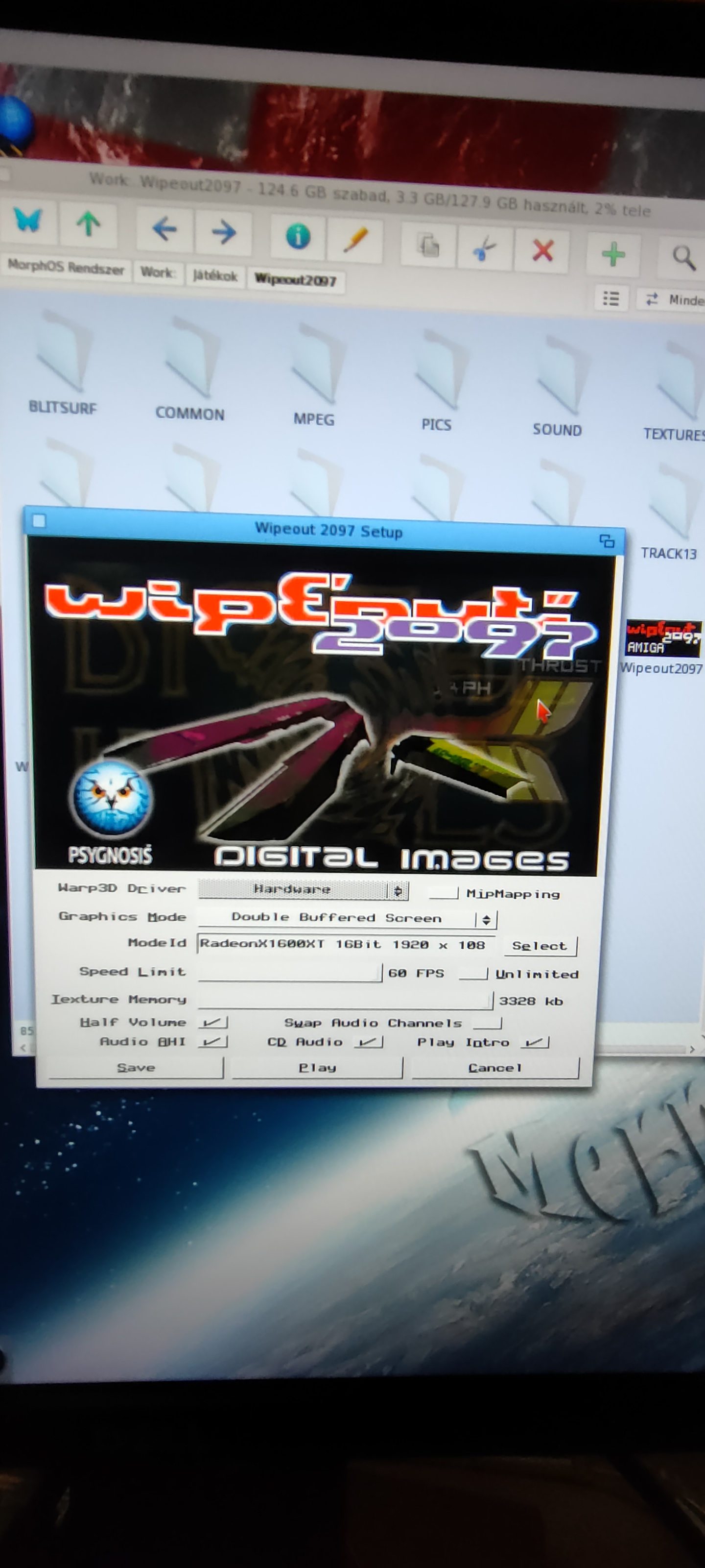

    koszer
    But did you think about the resolution? In 1996 (year the game was released) 1024x768 was kinda home standard and nobody really used anything above 1280x1024.
    Edit: That was of course a joke. I don't really see how lowering bit depth would help in any way (and it may be the reason why game fails on start).
    Let me answer also with this video.
    By the way: You may want to upload your video to YouTube, no need to overcomplicate things (although it seems you really like doing this).
    WARNING: I'm not sure how is it going to work on your setup, but in my case I had to lower the framerate, as at 60 FPS the game ran so fast it was extremely hard do play (about 2 times faster than it should, as seen on previous video). As you can see on the latest video (the one from this post), I've capped the FPS to 30 and that seemed to work quite OK.
    So far the game has started, although with faulty graphics, but it worked
    and I don't understand why it doesn't now
    it worked with the same screen settings until now

    I don't understand why you're saying I didn't answer the questions? I already wrote that I didn't do anything that would break MorphOS.
    I installed MorphOS from the CD, which I don't think can be done wrong because the installscript written by the MorphOS team does the installation.
    Then I installed the TiniGL and SDL packages, which also have a factory installer.
    What can I try from the MorphOS CD?
    I set the wallpaper and used the disk formatting program
    and that's about it
    You've written several times that the settings might be wrong
    I don't understand how it could be wrong
    when you install a system it should work and that's it
    If this doesn't happen, then we are talking about an non unuser-friendly system.
    It's one thing to remember how games worked in the past, and it's another thing to remember how well I installed what and how.
    I also mentioned that I cleaned the machine, applied new thermal paste, and tested it on macOS.
    Works stably under MacOS
    I didn't do anything unexpected
    I got help setting up warpz3D and did everything as advised
    You can see in the pictures that I used the settings recommended here.
    nevertheless, it's still not good
    I messed something up but I don't know what.?
