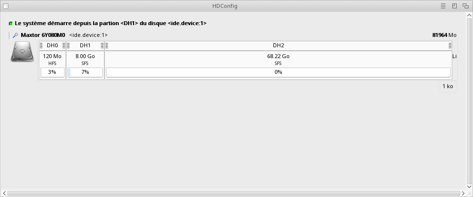

    Hi Amigaharry2!
    Please find the screen grap here  :-)
    Do you see anything wrong in it?
    Cheers!

    Please let me see how partitions are configured! (Pic, if you click on them)

    This message means that Kernel has bootet, but don't find a partition with the diskbased part to boot further.
    Therefore I want to see the config of your partitions. I guess something is wrong there..

    I uploaded the config of my partitions here: HDConfig, DH0, DH1, and DH2 (all created automatically by the installer).

    The latest driver is 52.43 from MOS 3.19. I don't think that your gra-card is the reason.
    For what I can see, your partitioning is OK. It's crazy that it does not boot! I can only imagine that you did something wrong in ENV-variables and/or NVRAM.
