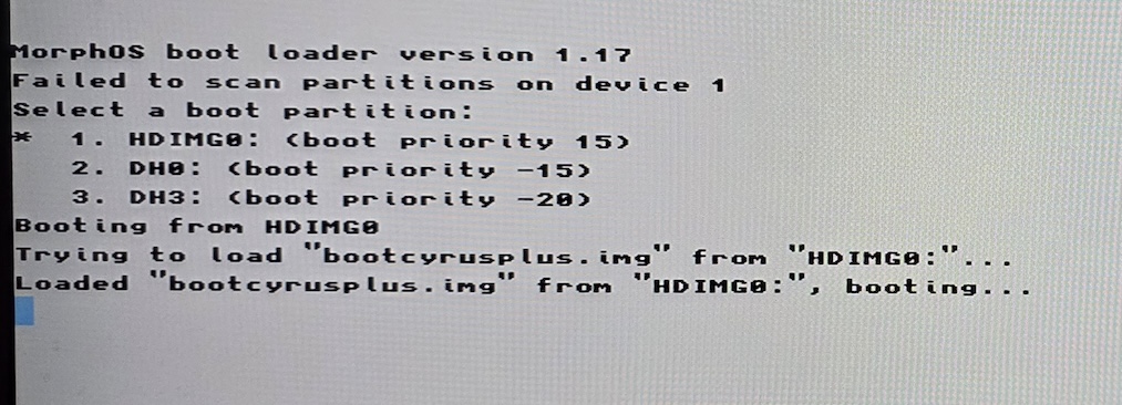

    Hi all,
    I was keen to give MorphOS 3.20 a go as it now appears to support the Radeon R7 240 card I have in my X5000/20. I have written the install image to a USB drive, and have done a "usb reset" followed by "bootmorphos" from the uboot CLI. This starts the bootloader, but just hangs at this stage - no further output is displayed, no matter how long I leave it.
    Any ideas ? Thanks!
    - Mark

    Same happens for me on X5000/040 with Radeon X1950.
    Booted 3.19 with no issues, installed on drive.
    Then I was lucky to get only 1 boot of 3.20 via usb, installed and now every boot hangs at the same message in serial log:
    MorphOS boot loader ve��io 1>17
    Booting f�o{"!0
    Tryig to load "bootcyrusplus>img" fro{"!0:"...
    Trying to load "boot>img" fro{"!0:"..>
    Loaded "boot>img" fro{"!0:", booting...
    x>13x�
    x.13x�
    8.13y ABox 1.30 (2>7>201x) � 1y99-2022 by Ral� Schmidt, E�mauel Lesueu�, Teemu Suikki, Harry Sintoe��H�x>1y1 P5040IitIDE@0: Drive prese_H�8.1y5 P5040_I/�%1: D�ive ��e�et
    x.284 P50x0 SATA D�iver@0: PIO Mode 4
    x.2xx P50x0 SATA Driver@0: UDMA Mode 6
    Full log from one successful installation and then reboot to not working disk installation:

    Hmmm. Have you found any workaround ? I tried setting the morphosargs envvar to "bm" to try and get the bootmenu, but that doesn't do anything either.

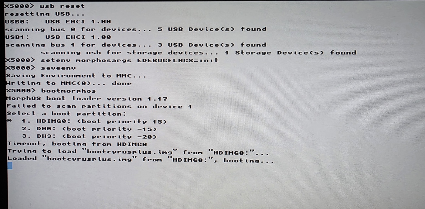

    Getting a log with EDEBUGFLAGS=init in your boot params could provide us with some additional information.
  • »04.06.26 - 22:38
    pampers
    Posts: 1068 from 2009/2/26
    @jacadcaps
    Just "bootmorphos EDEBUGFLAGS=init"?
    Tried twice, once the system started for my surprise.
    Second time didn't.
    EDIT: Tried with radeon 6950HD, it seems that on cold boot machine starts ok (doesn't matter what card) but after reset is dead again on the same messages.
    EDIT2: It's kinda of reproduceable with cold boot and then restart. Checked with 3 different gfx cards. It "feels" like something is missing in initialisation after reset or smth and then it dies.

  • »05.06.26 - 12:00
  • mdr
    Posts: 5 from 2026/6/2
    For what it's worth, neither cold or warm boots result in any progress for me. I'll try and hook up a serial cable and old laptop and capture some output if I can.
  • »05.06.26 - 17:42
    Posts: 3324 from 2003/3/5
    @pampers
    No idea how flags are set on the x5000 - never had one. This log does not look like they are set right though.
  • »05.06.26 - 20:49
  • mdr
    This looks like it has what you need to set boot args on an X5000 with uboot:
    MorphOS Boot Arguments on U-boot Systems
    I tried this with "setenv morphosargs bm" to see if I could get the boot menu, but nothing happened. Might work for other parameters or on your system though...
  • »06.06.26 - 09:11
    pampers
    @mdr
    Boot X5000, go to shell and type:
    setenv morphosargs EDEBUGFLAGS=init
    saveenv
    Basically enabling this flags "fixed" my system, cold boot, reboots, booting fine all the time now.
    @jacadcaps
    If your gmail I had in my records is still valid you should have a full log there.
    MorphOS 3.x
  • »13.06.26 - 16:11
  • mdr
    Thanks for the tip. How did you discover that debug flag? Sadly, I tried it with no improvement. Still hangs on boot.
  • »19.06.26 - 15:39
    @mdr
    It'd help if you could capture a serial log. Did you try both HDMI and DVI outputs? (I don't believe a 240 has a DP, but just in case your variant does - DP isn't supported).
