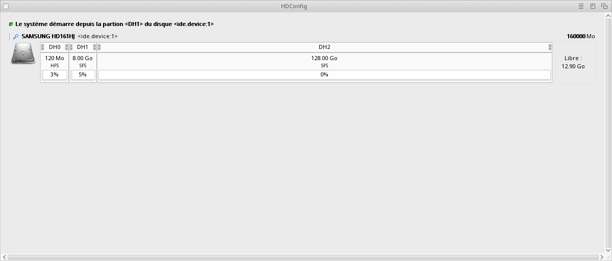

    Hi Amigaharry2!
    Please find the screen grap here  :-)
    Do you see anything wrong in it?
    Cheers!

    Please let me see how partitions are configured! (Pic, if you click on them)

    Hi Zeg and Amigaharry2
    So, I wanted to take screenshots of the partitions in HD-Tools... and MorphOS doesn't boot anymore! 🤦‍♂️
    Booting is stuck on "DO-QUIESCE finished_" and, because I haven't done much with it since yesterday, I think that it could really be the hard disk.
    I'll try with a "new" disk this week and let you know and I'll also check out different graphic cards!
    Talk to you soon!  :-)
  • »20.07.25 - 19:44
    Posts: 1341 from 2010/1/6
    This message means that Kernel has bootet, but don't find a partition with the diskbased part to boot further.
    Therefore I want to see the config of your partitions. I guess something is wrong there..

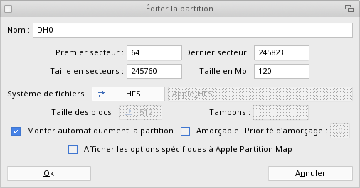

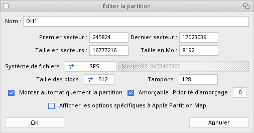

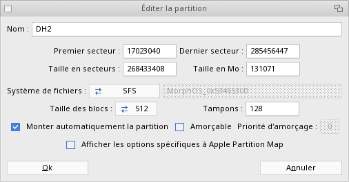

    Thanks for your help!  :-)
    So, I got another SATA disk, more modern!, and reinstalled MorphOS from scratch. As before, it went without a glitch!
    Still, same problem: my G5 chimes but only boots if I go in OF and type "bye" or "boot".
    I uploaded the config of my partitions here: HDConfig, DH0, DH1, and DH2 (all created automatically by the installer).

    The latest driver is 52.43 from MOS 3.19. I don't think that your gra-card is the reason.
    For what I can see, your partitioning is OK. It's crazy that it does not boot! I can only imagine that you did something wrong in ENV-variables and/or NVRAM.
