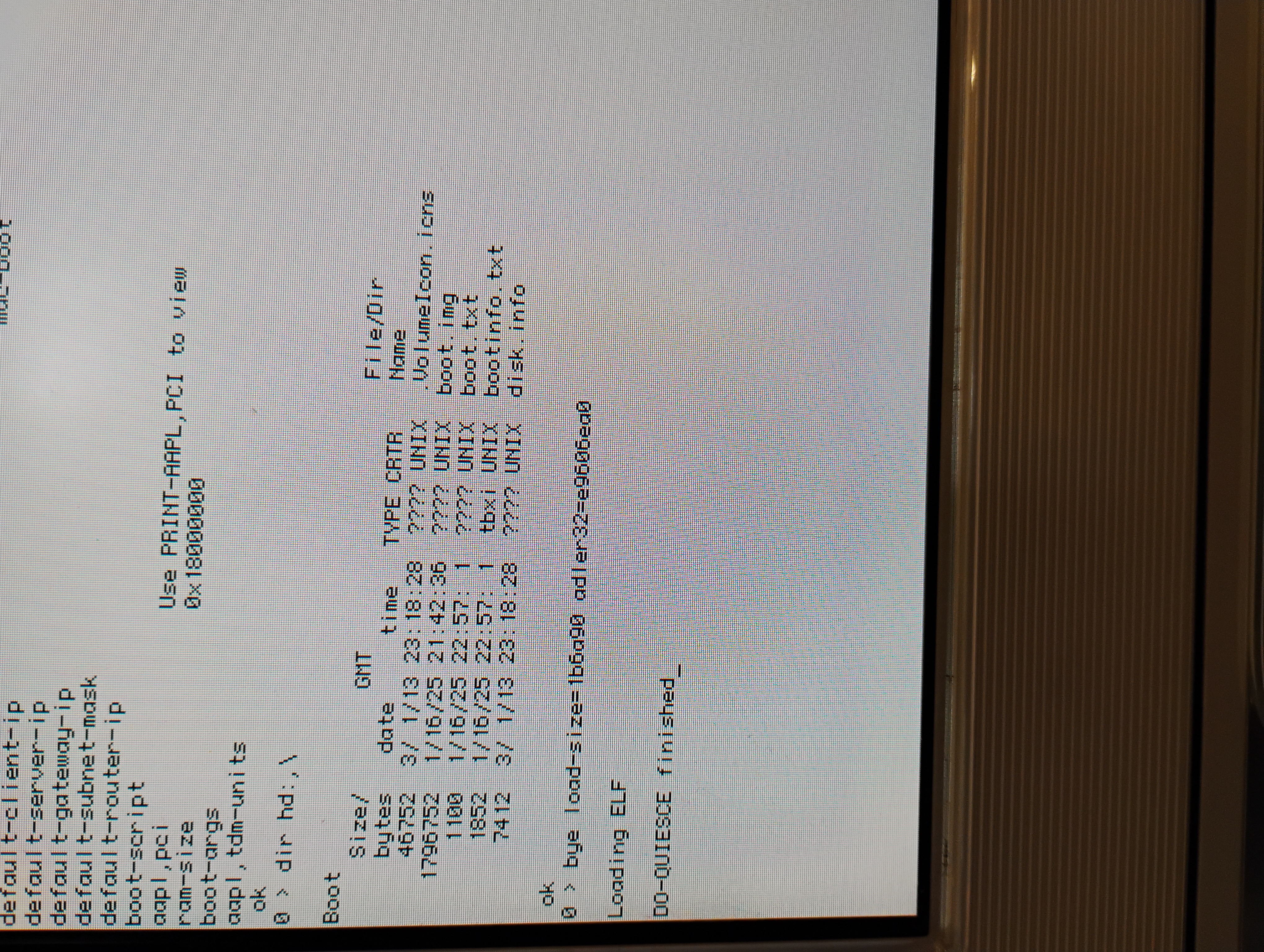

    I plugged the screen of a G4 in the second output of the graphic card and I can see OF! I can see again  ;-)
    Still no luck with the booting though... I'll share a screenshot of the variables but I realised something: my "hd:," was set to "/ht/pci@7/k2-sata-root/k2-sata@0/disk@0". This disk is not ATA. When I'd execute "dir hd:,\\", OF would say "not a ATA disk". My boot disk is "/ht/pci@7/k2-sata-root/k2-sata@1/disk@0" (on the second SATA port?).
    I managed to change the alias of "hd" in NVRAM by "setenv use-nvramrc? true" and "nvalias hd /ht/pci@7/k2-sata-root/k2-sata@1/disk@0", but it still doesn't boot automatically.
    I also "setenv boot-command boot hd:,\\bootinfo.txt", but it still doesn't boot automatically.
    So I don't know what's happening, because "boot" or "mac-boot" from OF boot MorphOS no problem...
    Cheers!

    PPS. I uploaded a screenshot of "printenv" here.
    I have changed:
    - "user-nvramrc?" to true, to use the saved "hd" alias (see below)
    - "skip-netboot?" to true, to skip that part (save some seconds?)
    - "boot-command" to "hd:,\\bootinfo.txt", to force booting on MorphOS
    I have also changed the alias for "hd" to "/ht/pci@7/k2-sata-root/k2-sata@1/disk@0" so that "dir hd:,\\" can access/list the content of the boot partition.
    Still no luck  :-( When starting the G5 without touching anything, MorphOS doesn't boot, and the G5 just shows a gray screen with nothing happening. When going into OF and typing "bye" or "boot" or "mac-boot", the G5 boots into MorphOS...

    After many more tests, I think that there's a problem either with the PCI bus or the Maxtor SATA hard disk...
    It's the only way to explain that:
    - I "setenv boot-command multi-boot"
    - I resetted the G5 and could see the MorphOS disk icon in the boot picker (but choosing it brought a "gray screen").
    Now I was sure that "boot-command" was doing something, though!
    - I "load hd:,\\boot.img" and saw the expected output ("... DO-QUIESCE finished.")
    - Then I "go" and MorphOS started.
    - I restarted the computer
    - I "boot hd:,\\boot.img" and, again, MorphOS started.
    Now I was sure that I had the correct "boot-command"!
    I "setenv boot-command boot hd:,\\boot.img" and restarted the G5 and got... a black screen!
    So the only explanation would be that pressing Option+Command+O+F and typing "bye" give time to the PCI bus or the hard disk or something to initialise???
    Guess this'll be the most secure computer at home: only I'll know how to boot it  ;-)

    I tried setting boot-device and boot-command as you suggested, but still no luck: the G5 chimes, then a black screen until I switch it off by pressing the power button.
    There's a difference with yesterday, though. When boot-device is "hd:,\\:tbxi" (its default value), the G5 would show a gray screen, but with "hd:,\boot.img", it's a black screen!
    https://www.reddit.com/r/ProgrammerHumor/comments/tgogft/sometimes_progress_looks_like_failure/
    I put the outputs of printenv and boot (from inside OF) here and here.
    Thanks!
