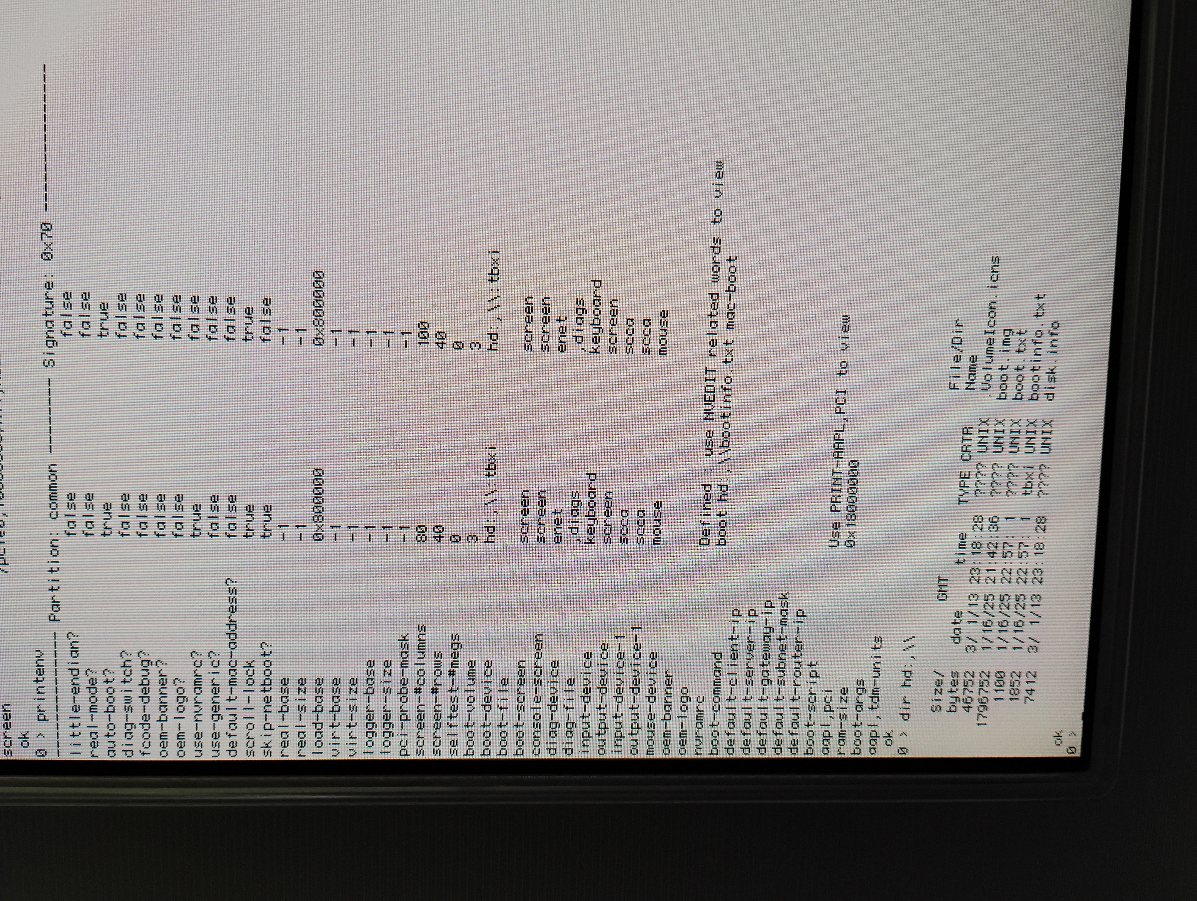

    PPS. I uploaded a screenshot of "printenv" here.
    I have changed:
    - "user-nvramrc?" to true, to use the saved "hd" alias (see below)
    - "skip-netboot?" to true, to skip that part (save some seconds?)
    - "boot-command" to "hd:,\\bootinfo.txt", to force booting on MorphOS
    I have also changed the alias for "hd" to "/ht/pci@7/k2-sata-root/k2-sata@1/disk@0" so that "dir hd:,\\" can access/list the content of the boot partition.
    Still no luck  :-( When starting the G5 without touching anything, MorphOS doesn't boot, and the G5 just shows a gray screen with nothing happening. When going into OF and typing "bye" or "boot" or "mac-boot", the G5 boots into MorphOS...

    Your boot-device points to a .tbxi-file on drive hd:. This is a special signed file, what OF is searching at begin and starts it.(like to our startup-sequence).
    To start MOS there is also a tbxi-file named bootinfo.txt. This file has to be "blessed" (signed), so that OF can find and start it (refer to doc on ISO - this file is located in mac_ppc32.
    It seems that in your case on hd: is no such file or not blessed! This can be done by shell command HFSSetMacBoot bootinfo.txt
    Then reboot.

    Is hd: the right partition with bootinfo.txt on it? And there is only one tbxi-file / partition allowed!
    To find out type dir hd:\
    bootinfo.txt should be in root-dir.
    There is no trace-fktn in OF (afaik). But from all I've seen your issue is not OF! It seems that the tbxi-file can't be found.

    Yes, I'm sure that "hd" is properly set because "dir hd:,\\" shows the content of the Boot: volume, and the file "bootinfo.txt" is of type "tbxi" (all the others are "????").
    It's very puzzling because starting the G5 "as is" will not start MorphOS but:
    - Going into OF and typing "bye" immediately will start MorphOS
    - Going into OF and typing "multi-boot" will show the MorphOS "disk" and selecting it will start MorphOS
    Crazy, eh?
