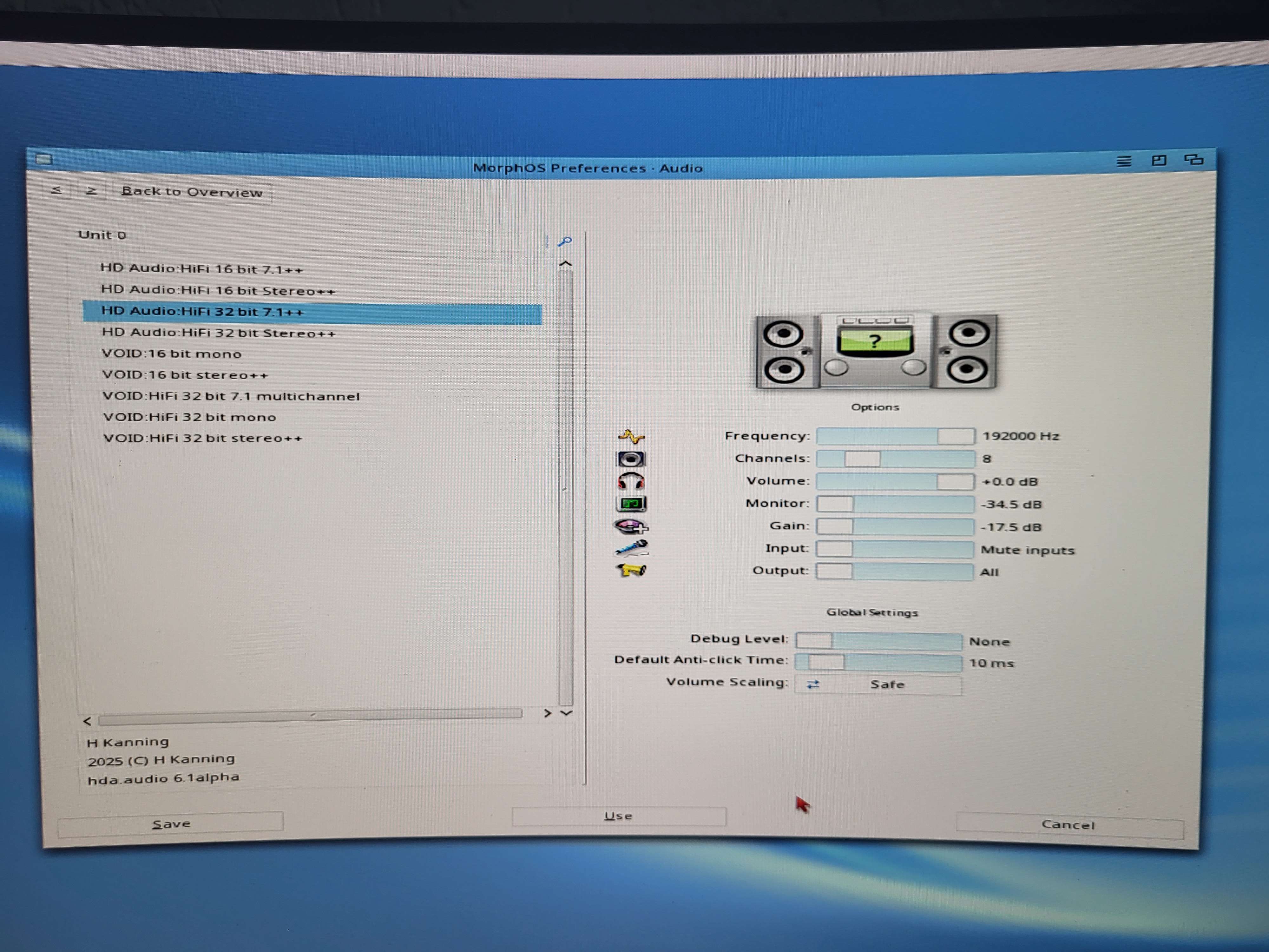

    13th June: "HD Audio driver for MorphOS
    Harald has just finished his first MorphOS driver. It’s for PCIe discrete soundcard complying with the Intel Hdaudio standard. That includes:
    Sound Blaster Audigy FX
    Sound Blaster Audigy FX V2
    CM8828+CM9882A cards
    https://mirari.vitasys.nl/wp-content/uploads/2025/06/HDaudio_Alpha_MOS.jpg

    Brumiga
    Posts: 263 from 2004/4/3
    @Andreas_Wolf,
    Do you know when the audio part will be supported/managed by the Trion FPGA chip ? I saw/read somewhere that this chip would/should do the job.
    Brumiga
  • »14.06.25 - 07:05
    Posts: 12405 from 2003/5/22
    That would be this part of the overall description:
    "The T1042 features an I2S interface for direct connection to external audio codecs, while the T208x does not. Therefore, we've implemented the I2S and S/PDIF controllers in the FPGA. This means there's no audio driver readily available for Linux. For OS4 and MorphOS, I have experience writing AHI drivers, so consider this covered."
    Sorry, I've no knowledge whether those controllers have already been implemented in the FPGA (and just the drivers missing) or are yet to be implemented (and if so, when).
  • »14.06.25 - 11:50
    Posts: 2446 from 2003/2/24
    Well the last "news" is that he got the drivers for a fancy surround sound PCIe card working, so I'd say
    no
  • »14.06.25 - 14:17
    Yes, see comment #83 :-) This is likely just a MorphOS port of the author's existing OS4 driver.
    > so I'd say no
    Strictly speaking, the statement regarding the I²S and S/PDIF controller implementation in the FPGA is written in present perfect tense, rather implying a 'yes'.
  • »14.06.25 - 15:17
    Posts: 30 from 2020/10/11
    The drivers build by @geennaam are the HDaudio drivers.
    It’s for PCIe discrete soundcards complying with the Intel Hdaudio standard.
    That includes:
    Its not the driver for the onboard FPGA yet.
  • »15.06.25 - 11:07
    > The drivers build by @geennaam are the HDaudio drivers. It’s
    > standard. [...] Its not the driver for the onboard FPGA yet.
    Yes, that's what's already been worked out in comments #82 to #87. Instead, the question (see comment #84) was whether the FPGA-based I²S and S/PDIF controller implementations have already been completed or not. The used language (see quote in comment #85) implies a 'yes', while others (see comment #86) assume a 'no'.
  • »15.06.25 - 11:27
    I can say the logic is in the FPGA and a Tone can be send to the Jack and Optical out.
    No driver yet.
  • »15.06.25 - 11:55
    Thanks for confirmation that both controllers have been implemented already.
  • »15.06.25 - 12:46
    No driver yet.
  • »15.06.25 - 15:08
