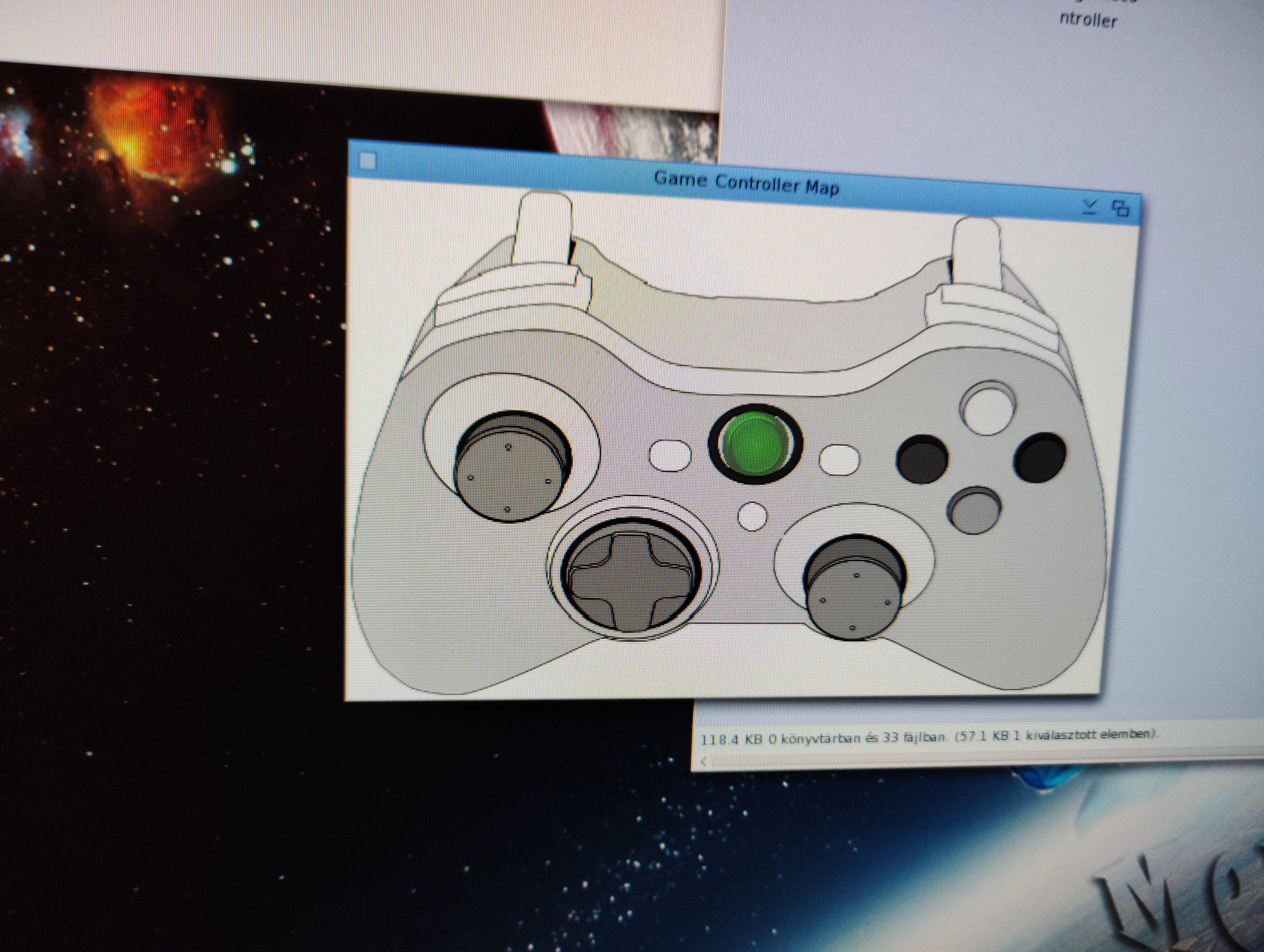

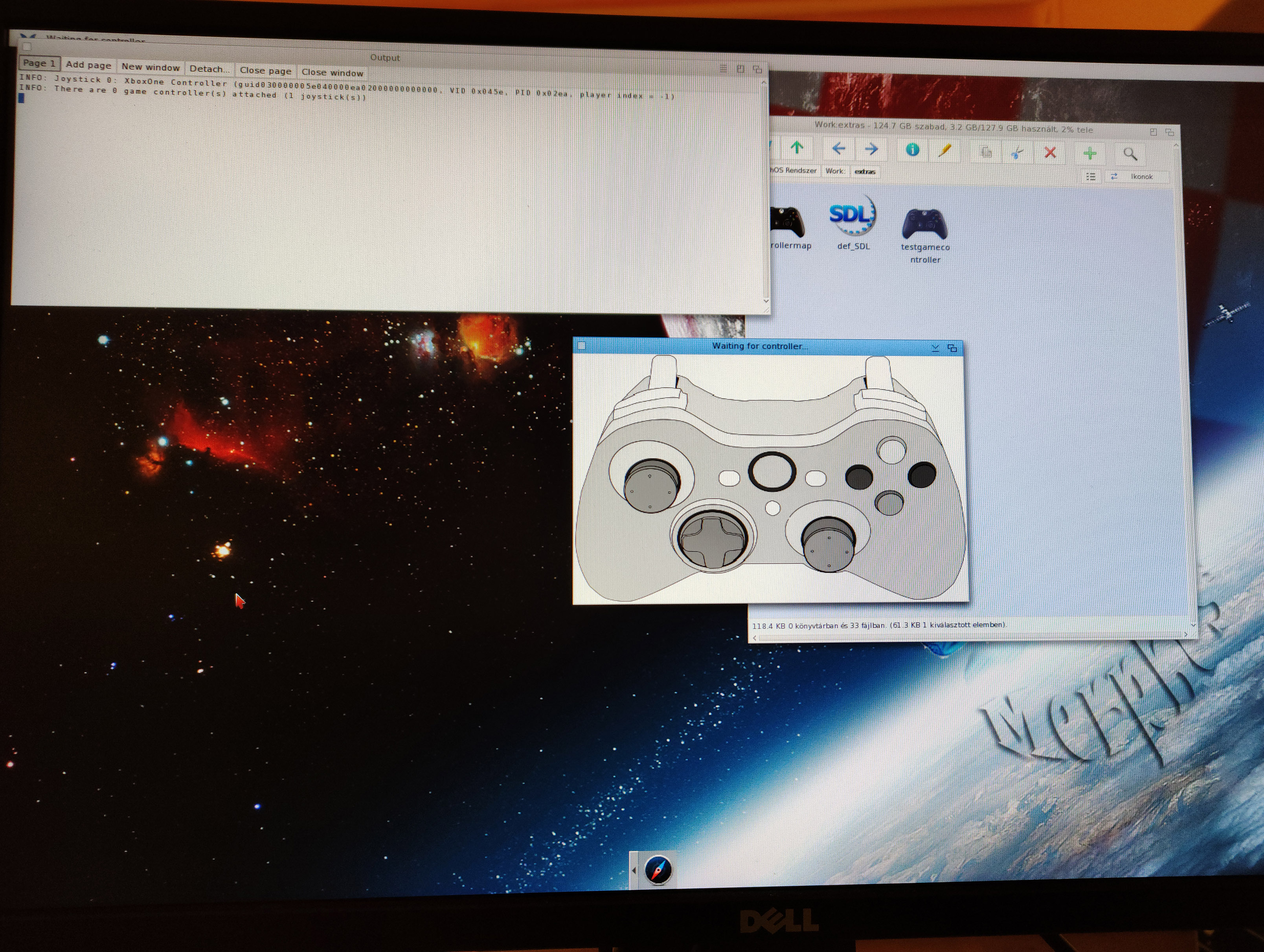

    I tried the controller test and it doesn't work
    "waiting for controller..."
    Controller map detects buttons but not the big Xbox button
    [img]MTkxMjcwOQ.jpg[/img]
    [img]MTkxMjcwOA.jpg[/img]

    Ok, so you need to create mapping for this controller.
    This is why you have some problem with all SDL2 games :-) game detect only joystick mode and not gamecontroller.
    So use ControllerMap to create new mapping each button and axis etc... if you dont find button, press SPACE to ignore it.
    When finish shell return new mapping, you nee to put new mapping into gamecontrollerdb.txt (ENVARC: and reboot your machine)
    And plz, hare your mapping, i put it for next release of SDL2/3, thanks
    Actual database:
    https://github.com/BeWorld2018/gamecontrollerdb.txt/blob/master/gamecontrollerdb.txt
    You find post here: https://meta-morphos.org/viewtopic.php?topic=2142&forum=52

    Try to add into gamecontrollerdb.txt: (normaly same as mine)
